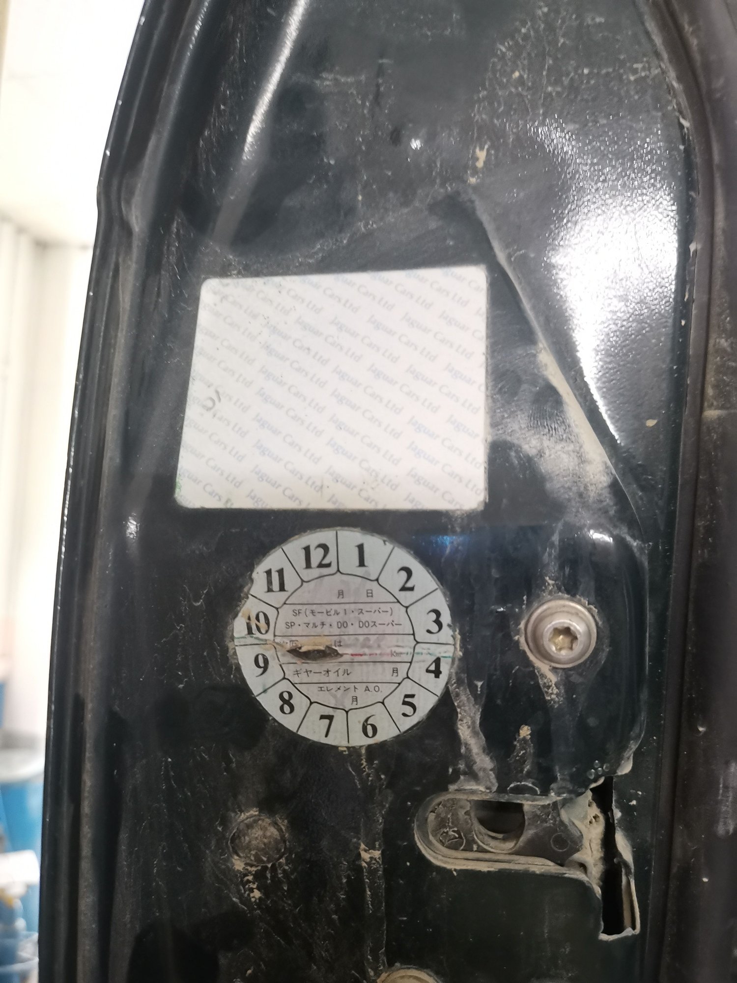

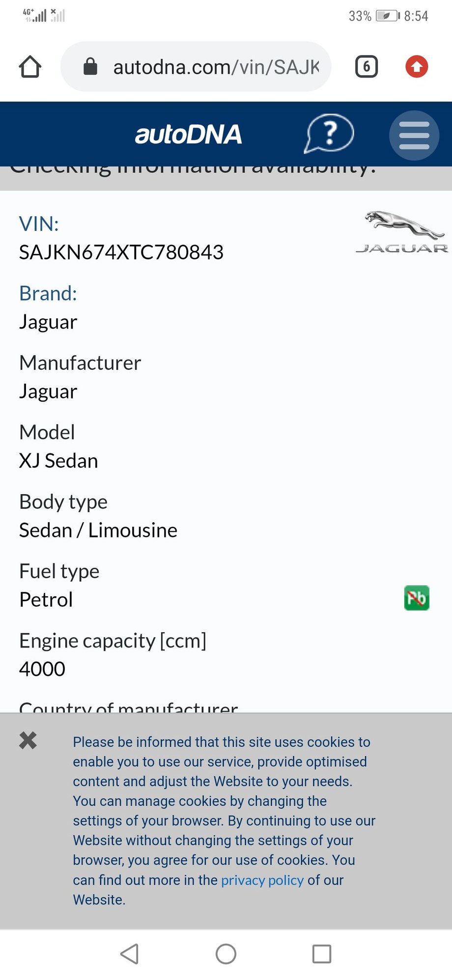

Thanks first, I'm living in United Arab Emirates - Dubai.
The car I saw that plate on door need to send you photo of it. As I remember was in English and some Japanese words.
I attached the chassis number info got it from Google pla look at it.
Really like this type and want it to be in good condition so looking for your help guys.

Attached what do you think is this USA or UK?

It looks like your car is a Japanese model (or at least it lived there for a while). Is the steering wheel on the right? If so, that would probably confirm it.
So there is a good chance that the car has the immobiliser system.

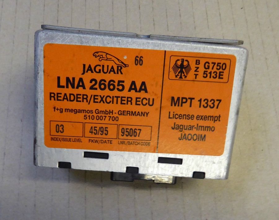

Look in the area of the steering column and behind the dashboard for a module that looks like this
This the the module that interprets the signal from the key through the reader unit which is around the ignition key barrel. If you have one of these modules then I think you certainly have an immobiliser and therefore starting the car without a key programmed to the car is going to be very difficult.

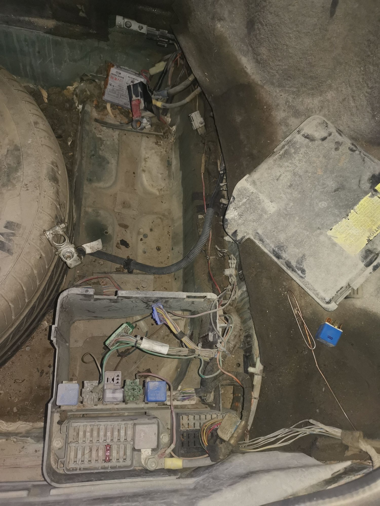

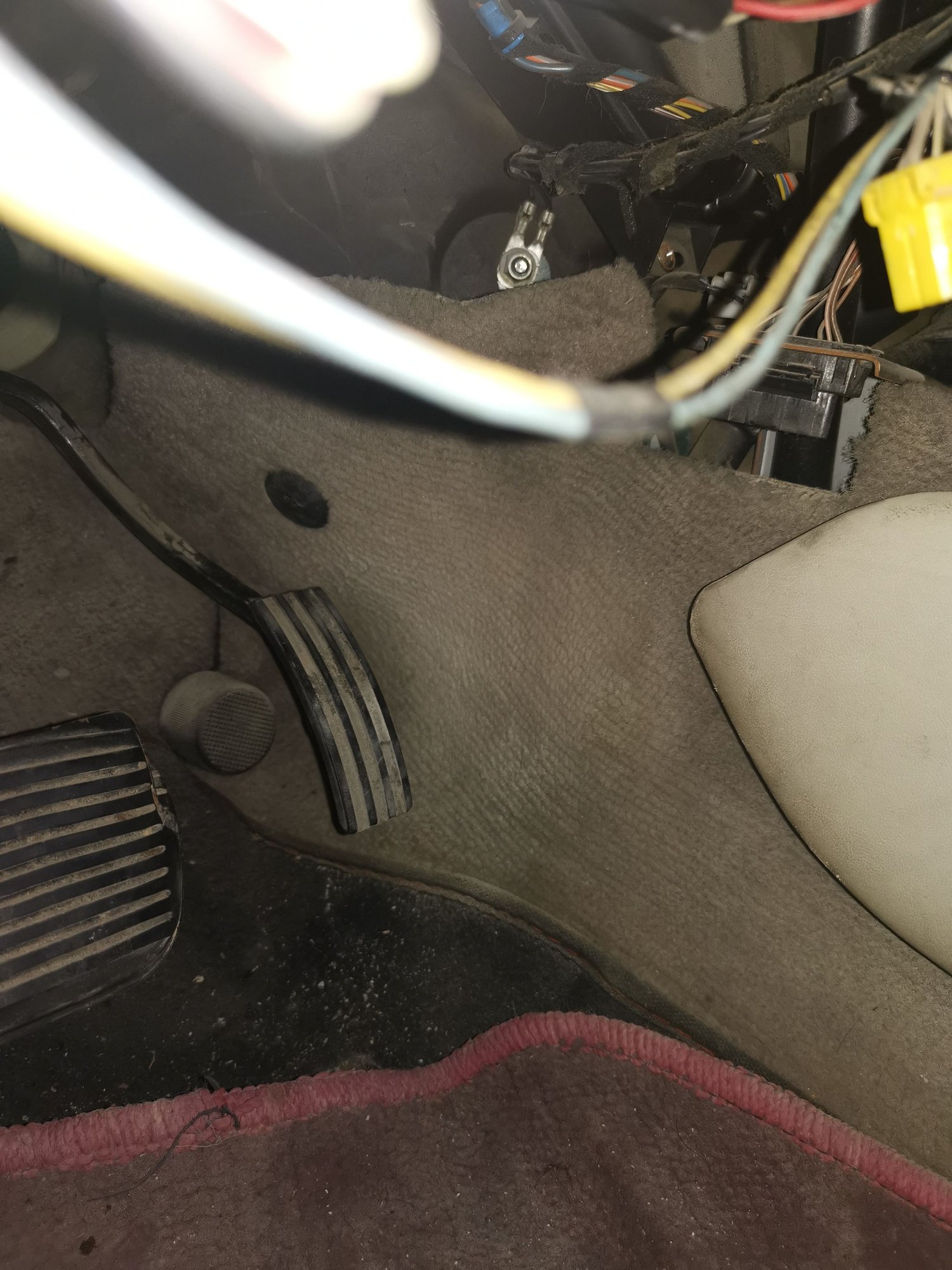

OK today we checked that there is No ECU and I took photo pls check also
Also checked all fueses that it's inside only the I guess the fuse of fuel pump damaged.
Also I found two boxes of Lamp control just wnat to inform you.
Also I called the key shop to confirm me that was no ECU device that to look the car. (and maybe it was but some one removed it as I can see the yellow fuse to connect it see the photos up)
So now I'm assuming need a good electrical man to check all car and if other pls let me know to do also.
