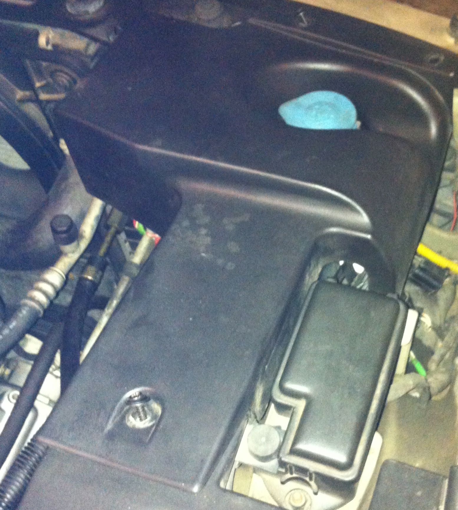

The right front of the engine bay.
Remove this plastic cover
The AIR relay is the one in the middle of the threesome.
If you don't already have it, go to the downloads post at the top of this forum and download the electrical guide for your car. It's free and invaluable. It also has the locations of all the relays, fuses and other electrical components.
