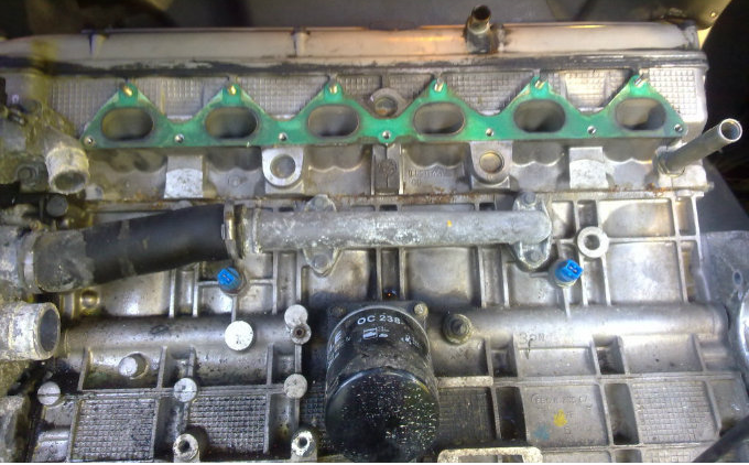

Perhaps it may be from the valve cover gasket or the engine coolant outlet tube / hose / clamp . Less intrusive look at . Alot harder would be the head gasket
