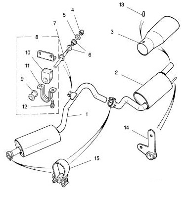

Hi, ive noticed that my right hand rear silencer is not mounted correctly and someone has bodged the job. Ive looked under the car and can see there isnt a rubber in the metal bracket. Can someone identify the part for me? Its driving me nuts just thinking about a bodged repair on the car and i must put it right.

Paul,
Is it Item 9 or Item 10 in this diagram?
Item 9: Bush - P/N CAC2750
Item 10: Mounting Rubber - P/N EBC4499

Graham, its 10. Which is black rubber. Are they universal on the x300s I have a 4.0 XJ6? Thanks for fast reply. I wasnt expecting a resonse so fast

Actually ithink its further back than that diagram shows. At the very rear of the car, almost under the rear bumper is a bracket that accepts the round bar from the rear silencer.

Could be the 'L' shaped Bracket (Item 14) which has a rubber insert?

Many thanks to Graham who helped me pick out the right bit to change. Now i just need to find one. Its definately 14

Strangely these brackets are handed:
RH = NNA6792AA
LH = NNA6793AA
I'd have expected them to be reversible.
