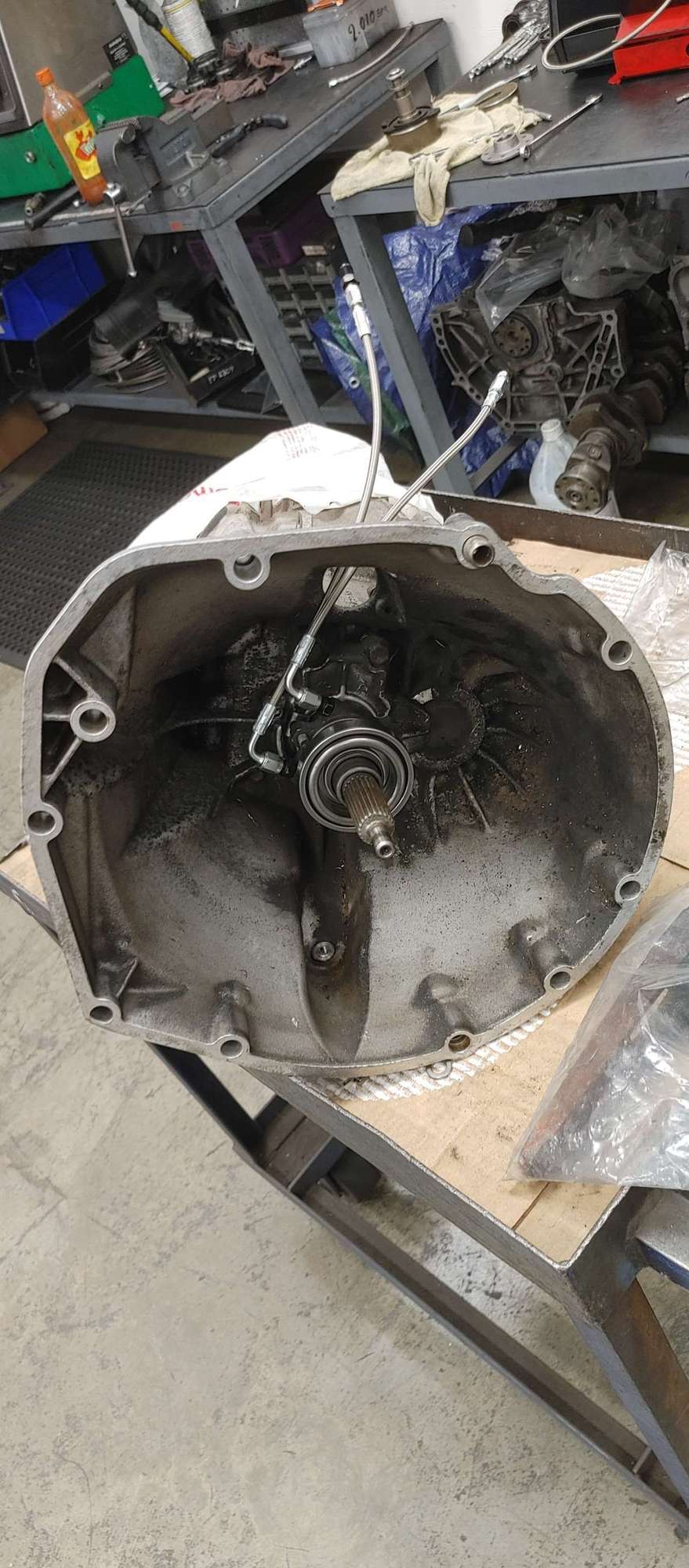

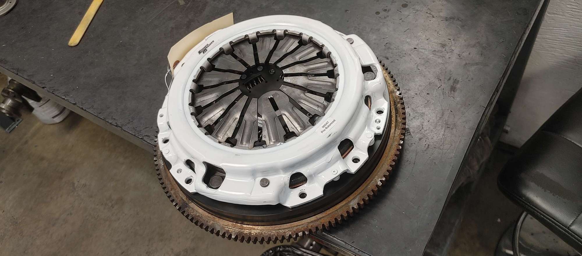

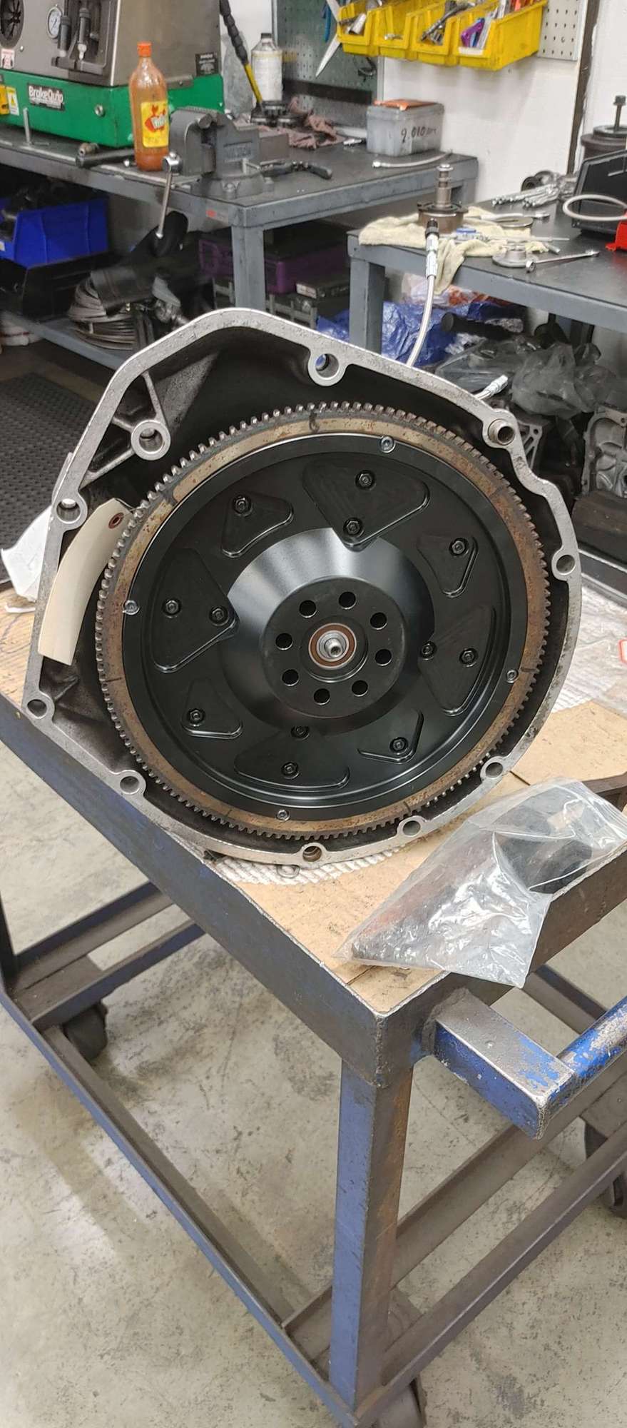

Updates! I have my new flywheel and clutch in hand, and it is a GORGEOUS package! See for yourself:
The pricing I talked about in my first post changed quite a bit, because the tech and I discussed several options and versions of how to get this project done. To put it plain and simple: we created a complete replacement package that leaves no guess work or extra bits to worry about.
Aluminum, single piece flywheel with serviceable friction surface and removable pilot bearing (a fully serviceable piece!) which utilizes the OEM ring gear.
Custom single-disc clutch package with cover bolts.
Custom hydraulic pusher slave with custom throw-out bearing
Shortened flywheel bolts.
Stainless Steel braided lines off the slave cylinder.
Shims.
The whole package is good to 525hp.
The big question, of course: $2,700 USD
I couldn't be happier with the setup, especially knowing that servicing the kit in the future will be MUCH cheaper than buying all new kit each time it wears beyond it's limits (and I won't have to worry about a supplier running out of stock on a part no longer made).
I cannot wait to get this project put together so I can tell you all how it drives!

I could only assume so. That mechanism with the large arm that reaches across the whole trans was... quite a design. Not sure about refined, though; this is a single piece flywheel in place of the OEM dual mass, so it'll definitely be a little "sportier".
