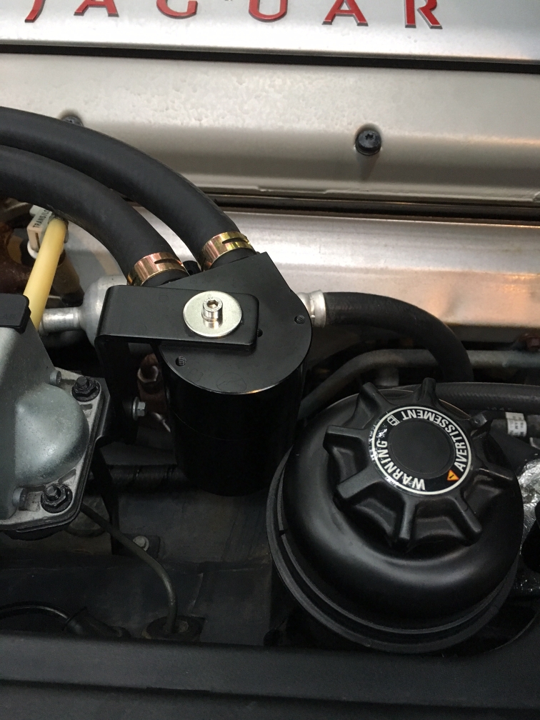

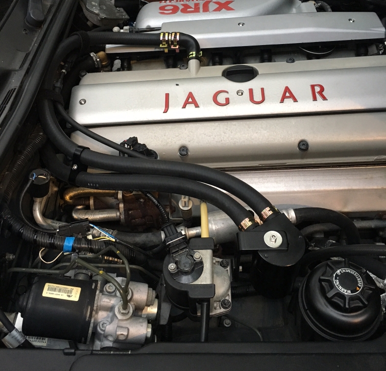

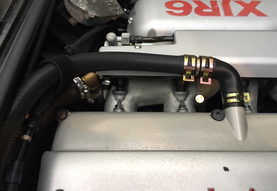

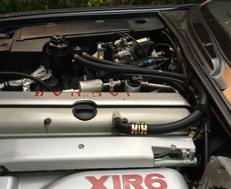

Finally took the time to take some photos of the finished installation. You can see on the closeup of the cam cover breather connection where the secondary small breather hose that goes directly to throttle body has been blocked off with a brass plug.
The catch can is a cheap knock off of a popular BMW can originally marketed by "BMS, Burger Motorsports" and is held on with some random black anodized bracket for a camera mount that bolts to the top of the can and the traction control mounting bracket.
