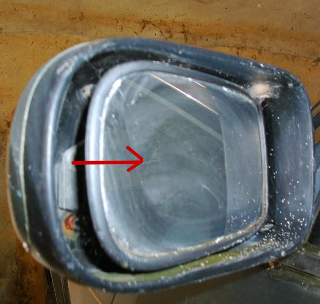

First, From the drivers seat, adjust the mirror so that it is turned in towards you to its full extent, see pic. This leaves the outer edge of the mirror clear of the plastic housing.
Then, at the outer edge, pull the actual glass towards you, away from the car and at the same time, pull it away from the housing, see pic.

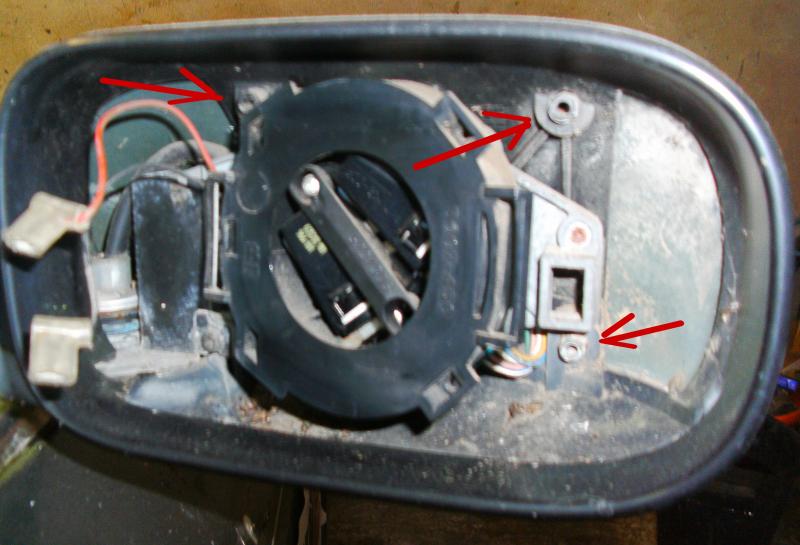

Then push the mirror back towards the car and this will release the rear "snap on " fixing. remove the heater wires and put the glass somewhere safe!

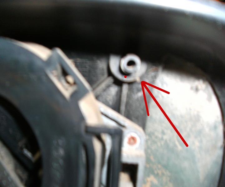

Inside the mirror housing you will see the Three plastic lugs that pass through from the cover into the actual mirror housing. The cover is held in place with these lugs, using collets, or small spring loaded sleeves. These sleeves can be removed with a pliers, or the cover can be pushed away from the housing, by pushing on the lugs. I used a small thin screwdriver that went inside the lugs and so wouldn't slip. It is all self evident when you see it.

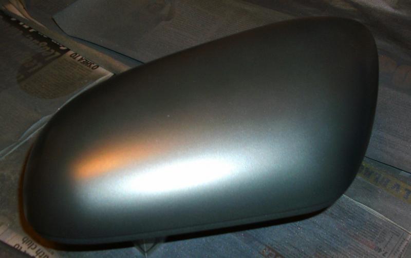

After that, it was rubbing, priming, flattening, cleaning, priming, painting (repeatedly, slowly building up very light mists, as water based paint tends to dry slowly and is prone to run!) and finally several clear coats, buffed and polished. The finish is actually much better than appears. One happy camper.
