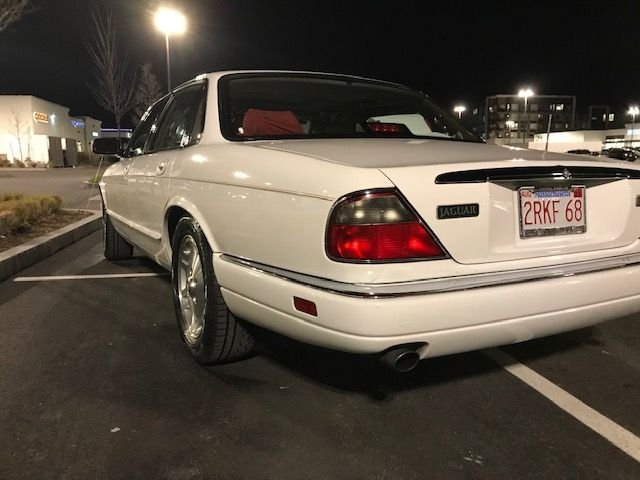

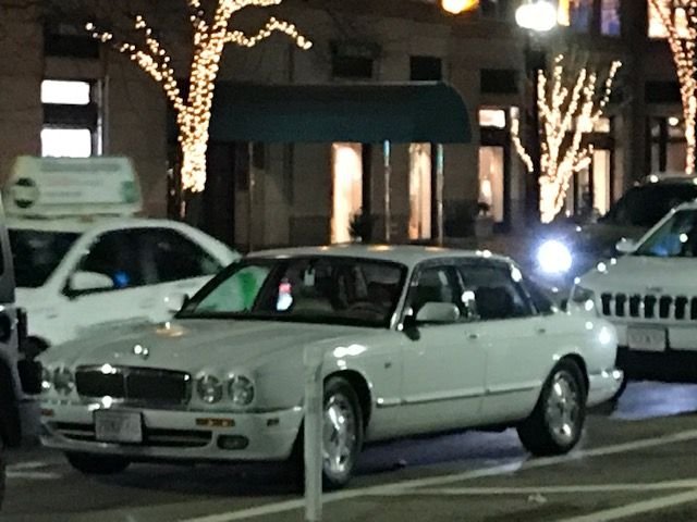

Also as an aside to my wheel bearing question, I also noticed low rear brake pads. Have others used TRW pads for rear pads on their Jaguar x300 with OK results? I think I read someplace TRW was original equipment, but who knows what is what brand these days. I also attached some shots of my Jaguar below. I drive it in the winter as long there is no wet salty snow. Trying to keep her nice buy also enjoy driving it. Car is from Miami so up until last September when I got it, it lived in a climate controlled garage.
