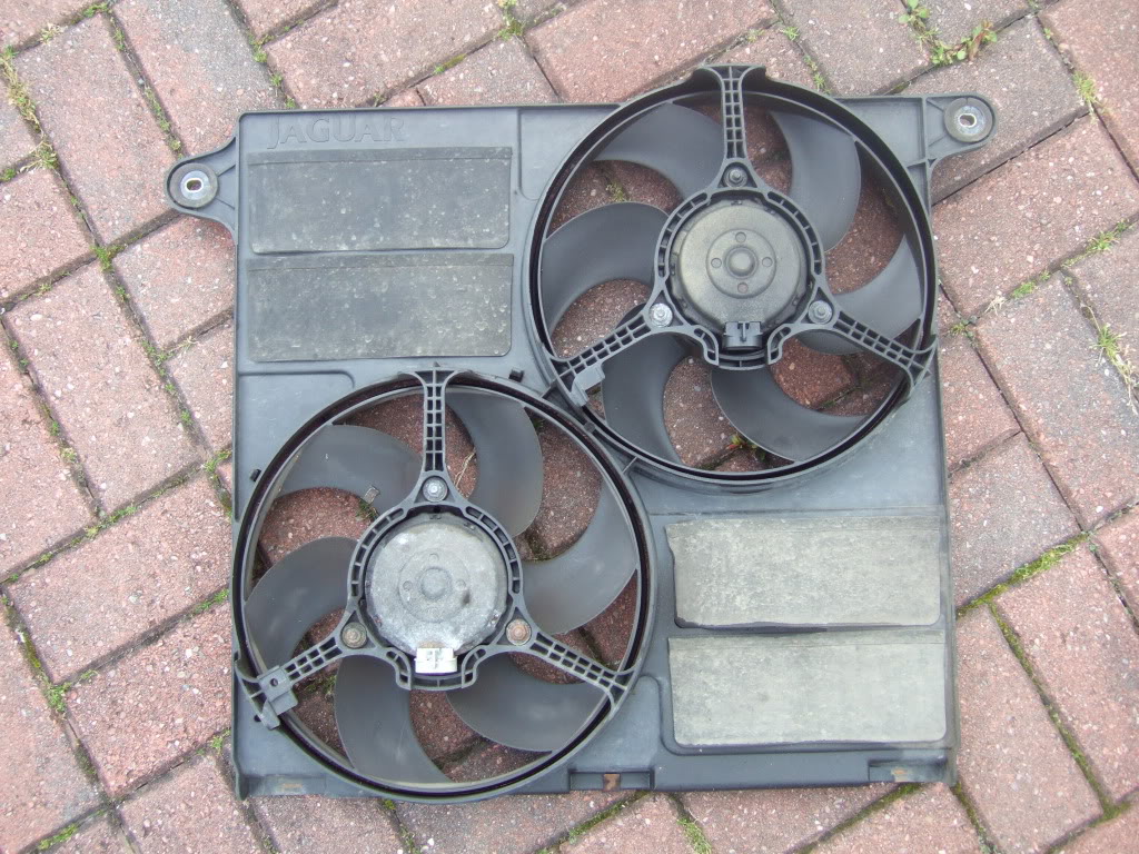

It turned out to be the Fan spindle was goosed !!
JAGUAR X300/330 FAN UNIT REPLACEMENT
I had been getting a vibration noise from the engine and it turned out the spindle in the top
fan had worked its way loose so the fan was shaking.
I spoke to a parts company and the told me £383.00 ++ for a new one
How many do they sell at that price?
I went on ebay and got one for £15.00 incl postage
After a little clean up, I fitted it, a 10 min job to remove the old one:

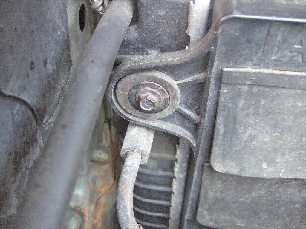

Two bolts out:

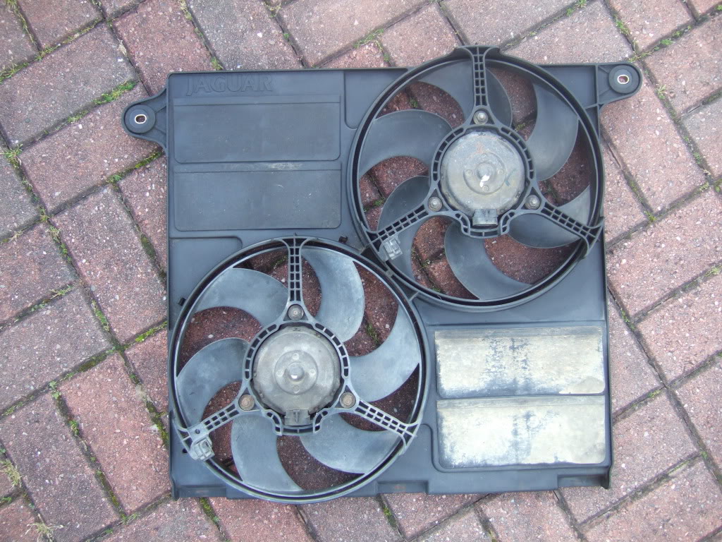

New one in:
Job Jobbed
I hope it helps someone
