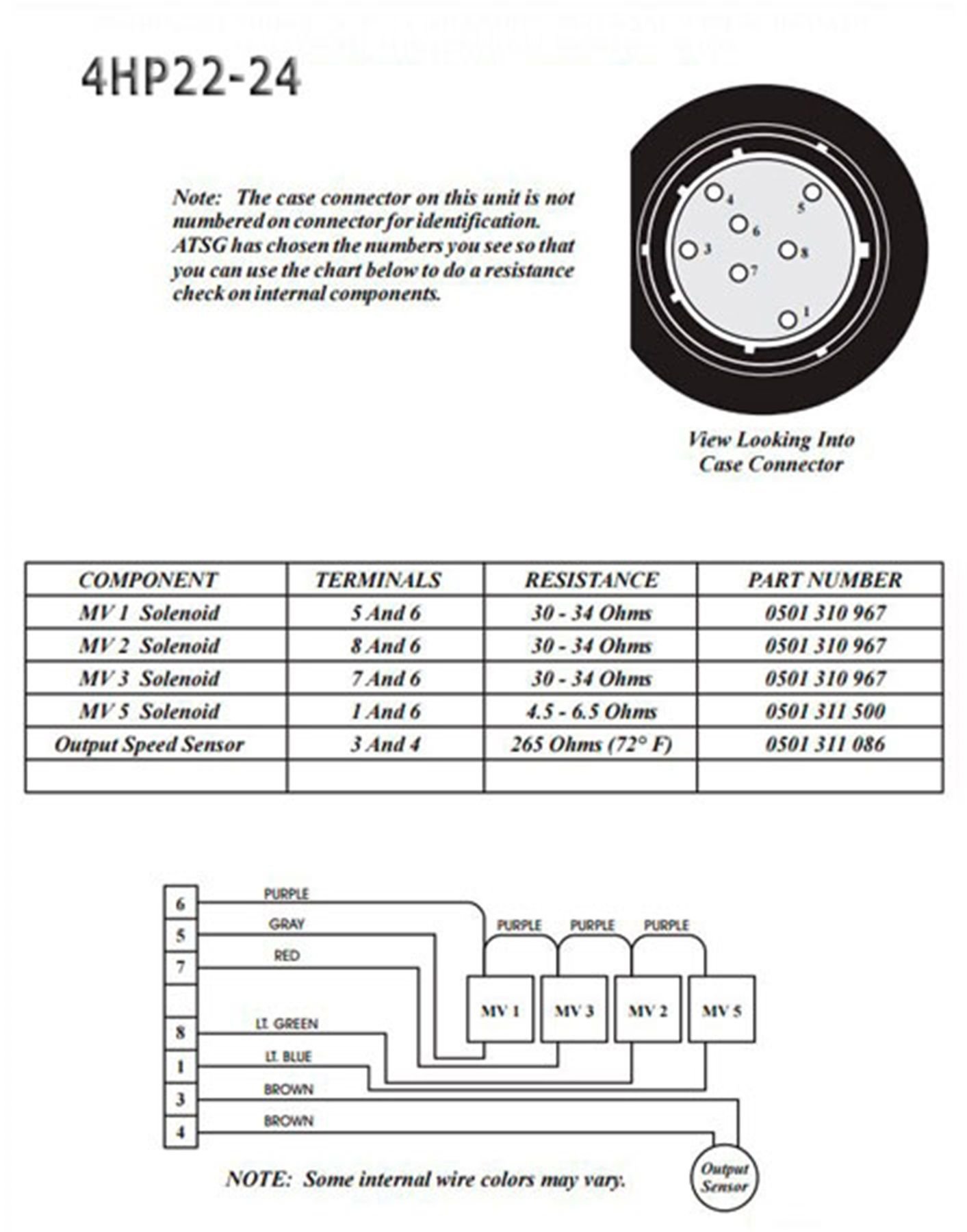

On the inline 6 / 4.0 liter you will have the ZF4HP24 transmission
The connector on the body of the transmission ( left side without jacking ) can be removed and put a meter on the internal shift solenoids
All the shift solenoids should read the same , 30 ohms , MV1 and MV2 , might as well check MV3 and MV4
When replacing a solenoid might as well chang all while there
The solenoids will most likely not fail until the transmission is fully warmed up
The trick to the connector is you must first move the connector aft 1 / 8 inch and only then twist it
You can use large tie wraps on the connector barrel to grip it

This connector can get dirty / oiled effecting the speed sensor inside the transmission body , the speed sensor by way of the transmission ECU talk with the engine ECU as they dance together though shifting / engine regulation
Usually , a fault around idle at a stop light or shifting gears out of park from reading others
