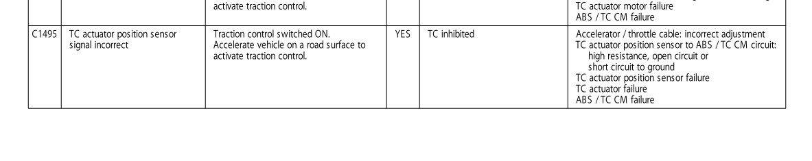

According to Jaguar manual, the description of that fault code is for Traction Control Actuator. I would expect an actual Throttle code (if the X300 actually has any?) to be a Pnnnn code not a Cnnnn. Where did you get your description from?
Here's the description from manual. I'd be very confident this has nothing to do with high emissions readings.
O2 Sensors is a good shout. Does your car have 2 or 4 sensors?
My understanding was that only US models had 4 sensors. RoW had 2. If you have 2 sensors then the Front Sensor (Upstream) is the the one that controls fueling and the one you need to be suspicious of.

Hi,
Ref. fault code C….
Thanks for your very good point. You are right, it is for Traction Control Actuator. For some reason, on factory tester, WDS, the description for this fault code is wrong.
and the fault code C1495 is true, my traction control is not working, no warning lights on dashboard. Need to sort out that also.
