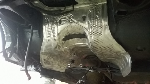

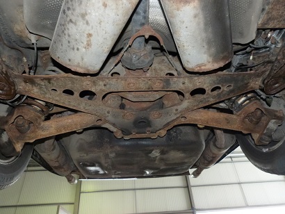

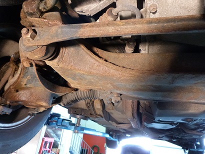

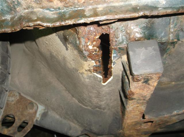

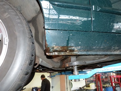

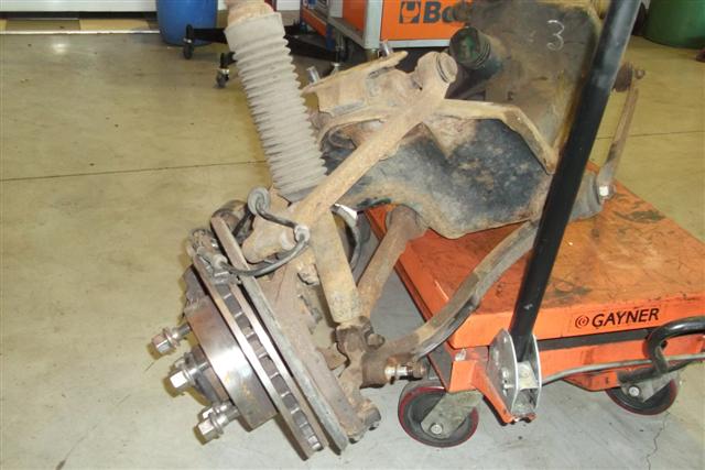

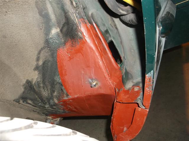

Here I post some photos of the restoration work done on my X300.
Story goes like that: This is a Norwegian registered Jag. It has been exposed to harsh winter conditions and salt loaded roads and consequently developed some rust problems. Although not making much economical sense, I decided to give it a good overhaul in a specialist garage. Of course, rust damage extended to much more than the visible area, but I also took the opportunity to change all possible wear parts (shocks, springs, bushings, ball joints, etc). Crossbeam member was also replaced, as the existing one had too much rust damage. Special care was taken in all that related to corrosion protection: Wax was injected in all possible orifices, bolts and nuts were zinc treated and Tectyl 506 was applied as last layer.
Parts were sourced mostly from UK, but also from Portugal and Switzerland.
The repair took almost 2 months, without many interruptions.
Well, it is needless to say that works have extended much more than planned, but I’m quite pleased with the outcome. I leave here some photos for you to judge by yourself.
Attached Thumbnails Rust repair works on my X300-x300-001-before.jpg   Rust repair works on my X300-x300-002-before-crossbean-rust.jpg   Rust repair works on my X300-x300-003-before.jpg   Rust repair works on my X300-x300-004-before.jpg   Rust repair works on my X300-x300-005-before.jpg
Rust repair works on my X300-x300-006-before-rear-end.jpg   Rust repair works on my X300-x300-007-before-rear-end.jpg   Rust repair works on my X300-x300-008-before-rear-end.jpg   Rust repair works on my X300-x300-009-before.jpg   Rust repair works on my X300-x300-010-before-hidden-rust.jpg

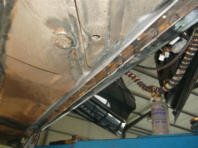

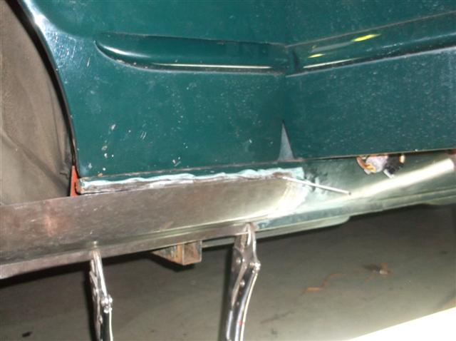

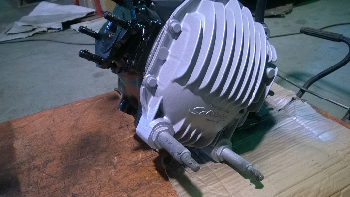

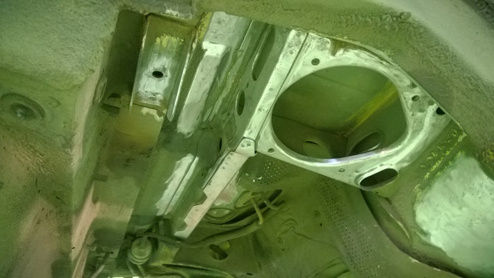

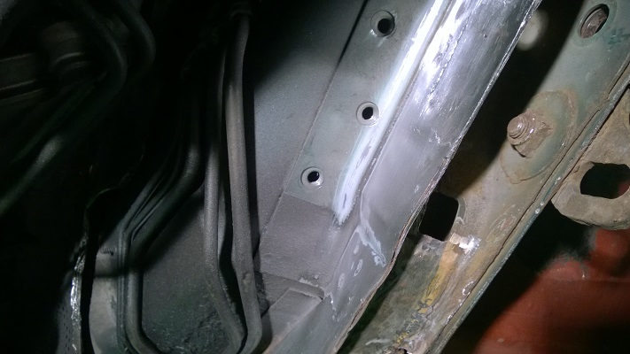

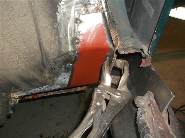

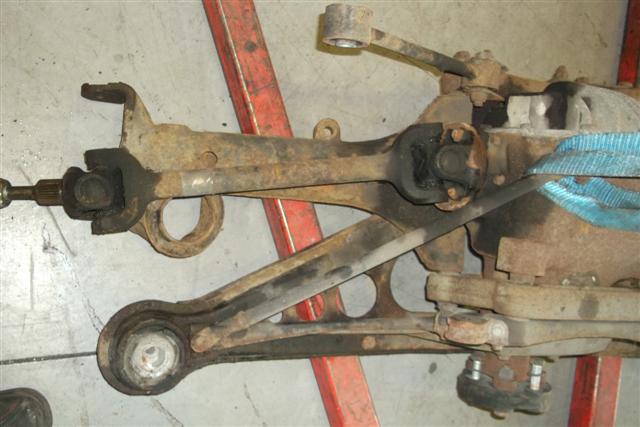

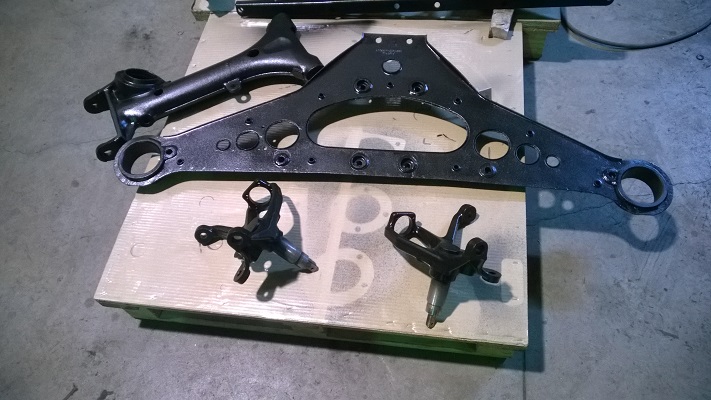

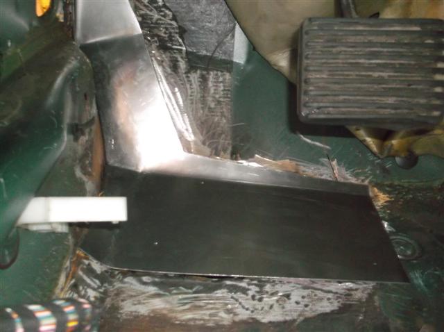

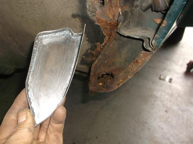

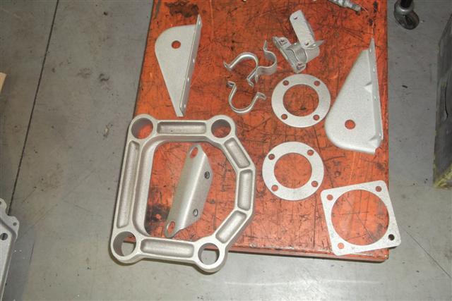

Repairs done

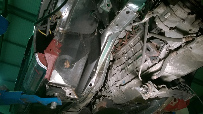

Attached Thumbnails Rust repair works on my X300-x300-020-weld-repair.jpg   Rust repair works on my X300-x300-021-weld-repair.jpg   Rust repair works on my X300-x300-022-weld-repair.jpg   Rust repair works on my X300-x300-024-weld-repair.jpg   Rust repair works on my X300-x300-025-weld-repair.jpg
Rust repair works on my X300-x300-026-weld-repair.jpg   Rust repair works on my X300-x300-027-weld-repair.jpg   Rust repair works on my X300-x300-028-weld-repair.jpg   Rust repair works on my X300-x300-029-weld-repair.jpg   Rust repair works on my X300-x300-030-weld-repair.jpg
Rust repair works on my X300-x300-031-weld-repair.jpg   Rust repair works on my X300-x300-032-weld-repair.jpg   Rust repair works on my X300-x300-033-weld-repair.jpg   Rust repair works on my X300-x300-034-weld-repair.jpg   Rust repair works on my X300-x300-035-weld-repair.jpg
Rust repair works on my X300-x300-036-weld-repair.jpg   Rust repair works on my X300-x300-040-dif-before.jpg   Rust repair works on my X300-x300-041-parts.jpg   Rust repair works on my X300-x300-042-during-works.jpg   Rust repair works on my X300-x300-043-parts-dif-before.jpg
Rust repair works on my X300-x300-044-parts-before.jpg   Rust repair works on my X300-x300-045-dif-before.jpg   Rust repair works on my X300-x300-050-parts-sandblasted.jpg   Rust repair works on my X300-x300-051-parts-sandblasted.jpg   Rust repair works on my X300-x300-052-dif-sandblasted.jpg

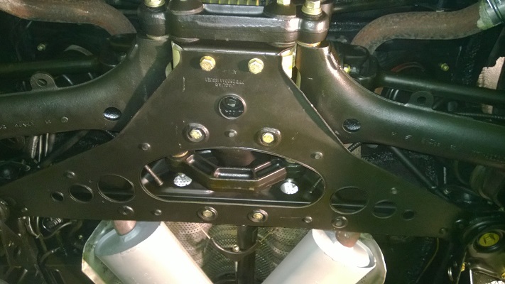

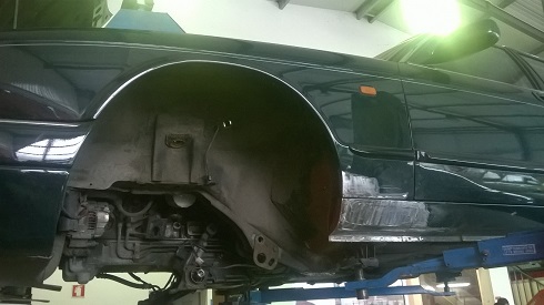

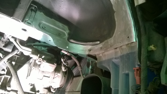

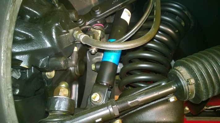

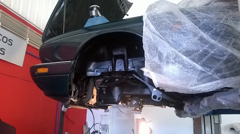

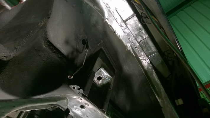

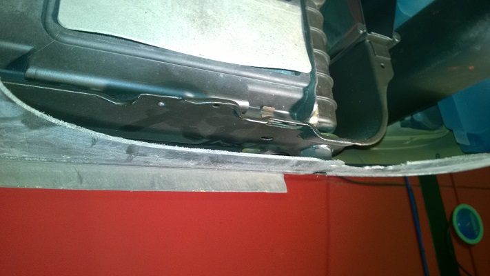

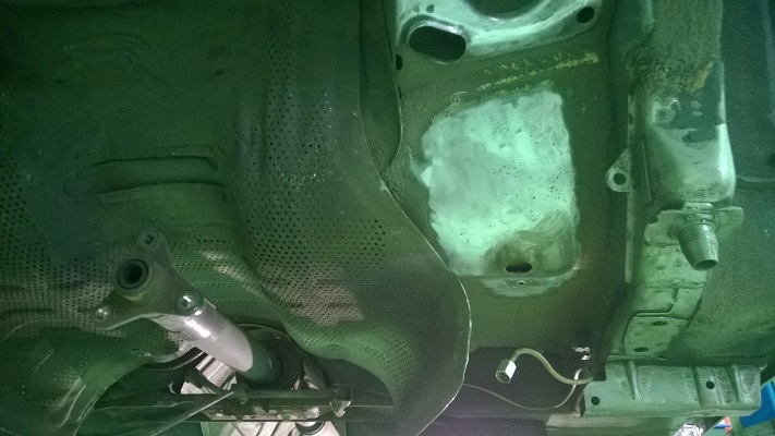

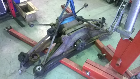

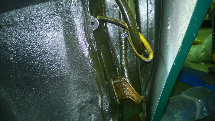

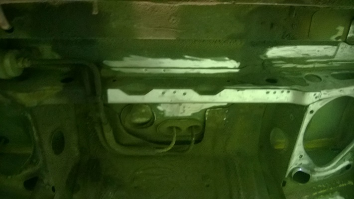

Some more photos.

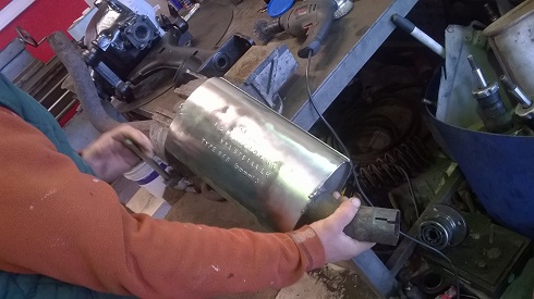

Attached Thumbnails Rust repair works on my X300-x300-060-during-works.jpg   Rust repair works on my X300-x300-061-during-works.jpg   Rust repair works on my X300-x300-062-during-works.jpg   Rust repair works on my X300-x300-063-during-works.jpg   Rust repair works on my X300-x300-064-during-works.jpg
Rust repair works on my X300-x300-065-during-works.jpg   Rust repair works on my X300-x300-066-during-works.jpg   Rust repair works on my X300-x300-067-during-works.jpg   Rust repair works on my X300-x300-068-during-works.jpg   Rust repair works on my X300-x300-069-during-works.jpg
Rust repair works on my X300-x300-070-during-works.jpg   Rust repair works on my X300-x300-071-during-works.jpg   Rust repair works on my X300-x300-080-parts-ready-dif.jpg   Rust repair works on my X300-x300-081-parts-ready.jpg   Rust repair works on my X300-x300-082-parts-ready.jpg
Rust repair works on my X300-x300-083-during-works-mid-exhaust.jpg   Rust repair works on my X300-x300-084-parts-ready-dif.jpg   Rust repair works on my X300-x300-085-reassembly.jpg   Rust repair works on my X300-x300-086-corrosion-protection.jpg   Rust repair works on my X300-x300-087-corrosion-protection.jpg

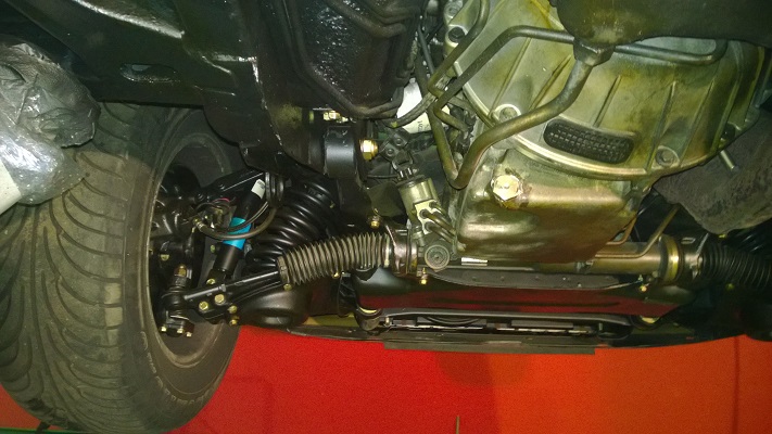

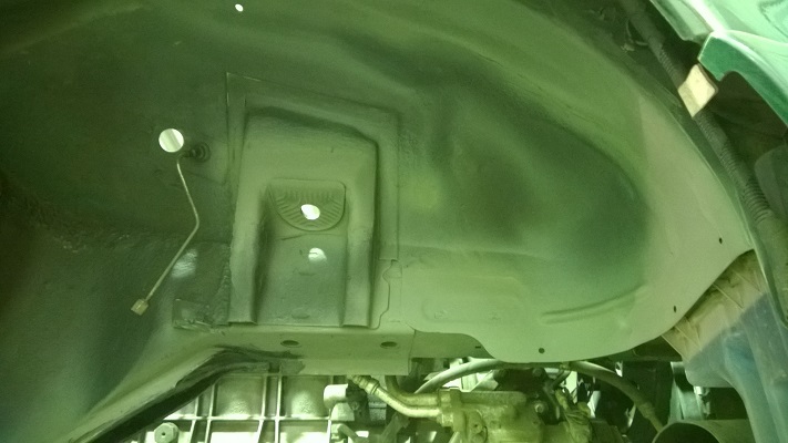

Rust repair works on my X300-x300-088-corrosion-protection.jpg   Rust repair works on my X300-x300-089-corrosion-protection.jpg   Rust repair works on my X300-x300-090-reassembly.jpg   Rust repair works on my X300-x300-091-corrosion-protection.jpg   Rust repair works on my X300-x300-092-corrosion-protection.jpg

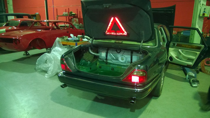

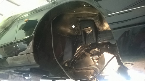

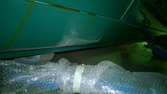

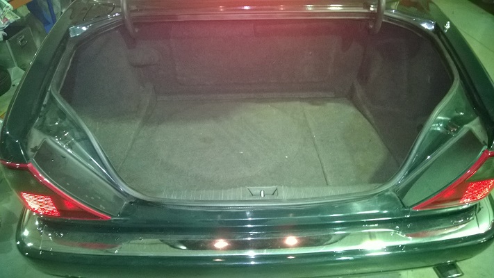

Work mostly done!

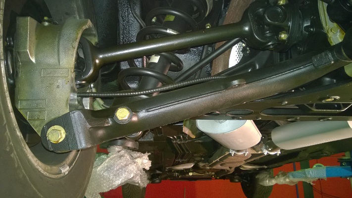

Attached Thumbnails Rust repair works on my X300-x300-200-work-done.jpg   Rust repair works on my X300-x300-201-work-done.jpg   Rust repair works on my X300-x300-202-work-done.jpg   Rust repair works on my X300-x300-203-work-done.jpg   Rust repair works on my X300-x300-204-work-done.jpg
Rust repair works on my X300-x300-205-work-done.jpg   Rust repair works on my X300-x300-206-work-done.jpg   Rust repair works on my X300-x300-207-work-done.jpg   Rust repair works on my X300-x300-208-work-done.jpg   Rust repair works on my X300-x300-209-work-done.jpg
Rust repair works on my X300-x300-210-work-done.jpg   Rust repair works on my X300-x300-211-work-done.jpg   Rust repair works on my X300-x300-212-work-done.jpg   Rust repair works on my X300-x300-213-work-done.jpg   Rust repair works on my X300-x300-214-work-done.jpg
Rust repair works on my X300-x300-215-work-done.jpg   Rust repair works on my X300-x300-216-work-done.jpg   Rust repair works on my X300-x300-217-work-done.jpg

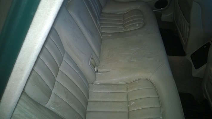

Leather care tentative: Worked so-so.
Attached Thumbnails Rust repair works on my X300-x300-219-leather-treatment.jpg   Rust repair works on my X300-x300-220-leather-treatment.jpg   Rust repair works on my X300-x300-221-leather-treatment.jpg

As soon as I saw the photo of the front crossbeam I thought it would be a problem. The seams let in water which then rots them from the inside.
Great job!
Great job!
Hi Graham,
Thanks.
Interestingly, to the point of your remark, the old crossbeam was PU filled. I’m not certain if it is original or if done at some point in time. Obviously, I did not want to find if the new one is also PU filled.
Regards,
Jorge
Regards,
Jorge
Jorge,
I found the same the first time I went to repair one! The very early ones didn't have the fill but it was soon specified by the factory to reduce noise transmission.

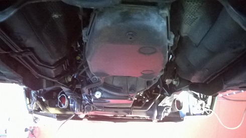

In my quest to bring back the X300 to as new condition… Steering wheel was somewhat used and I found a brand new one in ebay decently priced.
What is missing to be nearly spotless?
  • Refurbish the wheels. They are not bad, but since I’m at it… If I’m able to find some center caps, I may be replacing them as well.
  • Replace the bulb on the third stop light (aftermarket, but quite ok) by a red led bulb. It is ordered. The actual one is clear color and becomes too bright.
  • Repair small oil leak. It is a small crack in the sump, at the drainage bolt location. I’ll try with the “welding paste” on the next oil change.
  • Passenger side window way too slow, nearly stopping on its way up. I’m not certain what can be done. All is tight and fit. Replace the motor, perhaps? I have to check here in the forum if others had the same problem.
  • And the dashboard clock, which obviously is not functioning. I’m considering leaving it as it is, as I don’t want to risk sending it to repair.
