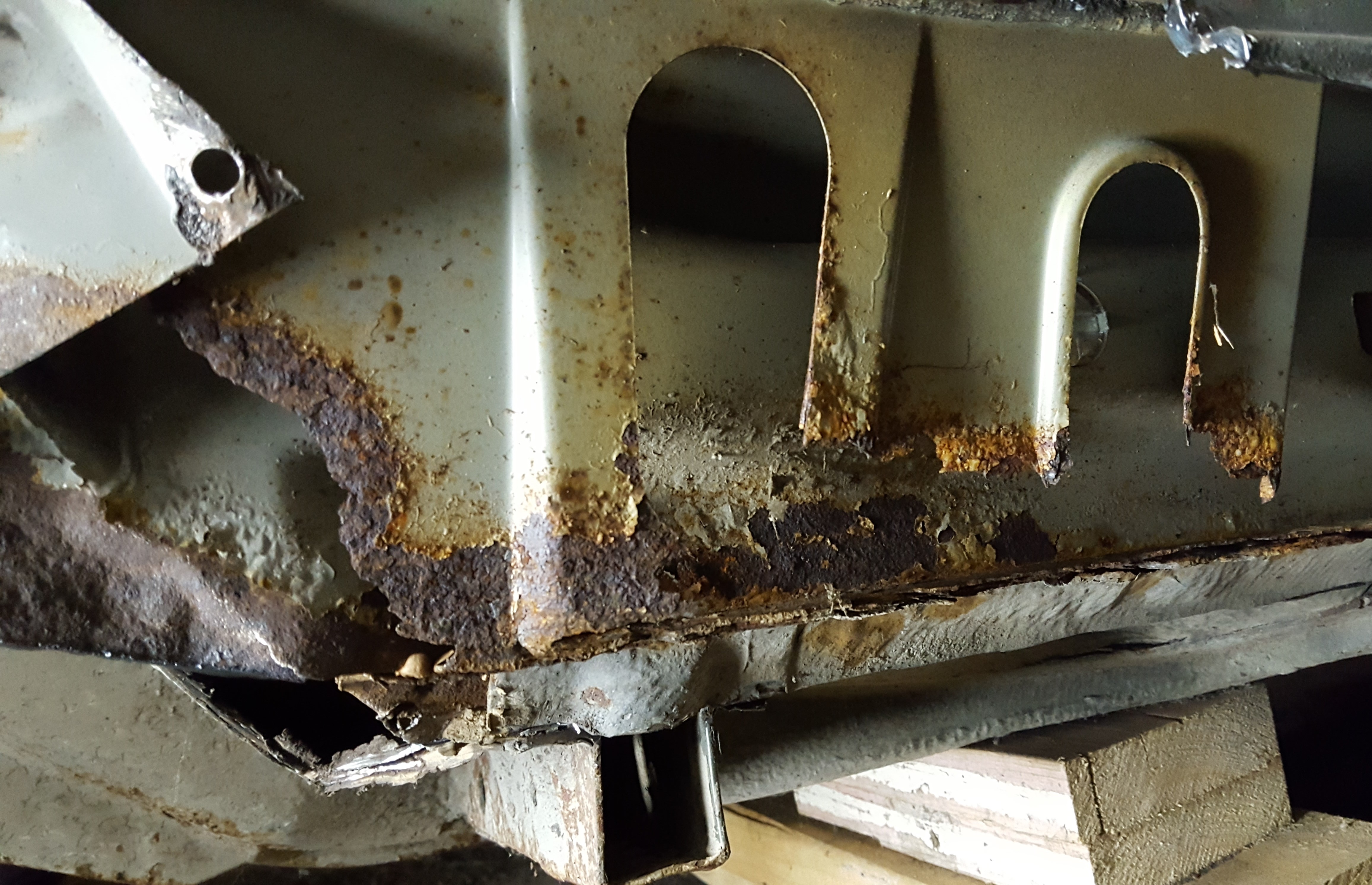

The wing/fender would have been an easy fix as it's a standalone part. The plan was to remove the wing (just some bolts) and cut off the offending part and weld in a replacement panel taken from my donor car.
The repair to the sill meant cutting off a section of the lower sill from my very clean donor car and using this to patch in the repair to my car.
But after cutting off the panel you can see what I found underneath. You can see that part of the actual structure has completely corroded away, and this is before anything has become evident on the outside. Given how clean the exterior of my donor sill section was, as opposed to the exterior of the sill section on my daily driver was, I could only imagine what it was like underneath.
The pictures might illustrate this better and show you what's going on underneath, in regard to both the actual construction and possible corrosion.
As previously stated, if you seal in the corrosion, it has nowhere left to go but out through the bodywork. I think a proper, more permanent fix is to cut away the damage, replace it, then seal things up and then do your final "cosmetic" finished repair.
Not wishing to frighten you, just to inform you and the best of luck with keeping your baby at her best.
