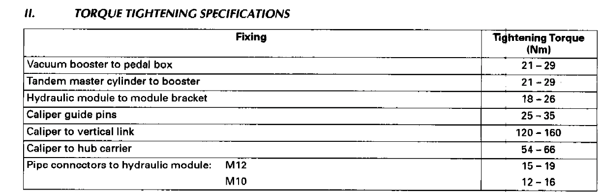

The title says it all. I have looked and cannot find the torque spec. Any input appreciated.

The only settings that Jaguar qoute for brakes are these.
So as not mentioned I would say just very tight!

Cafcpete has offered the only Service manual info. that appears available.
I just did a google search and AI came up with the attached -
