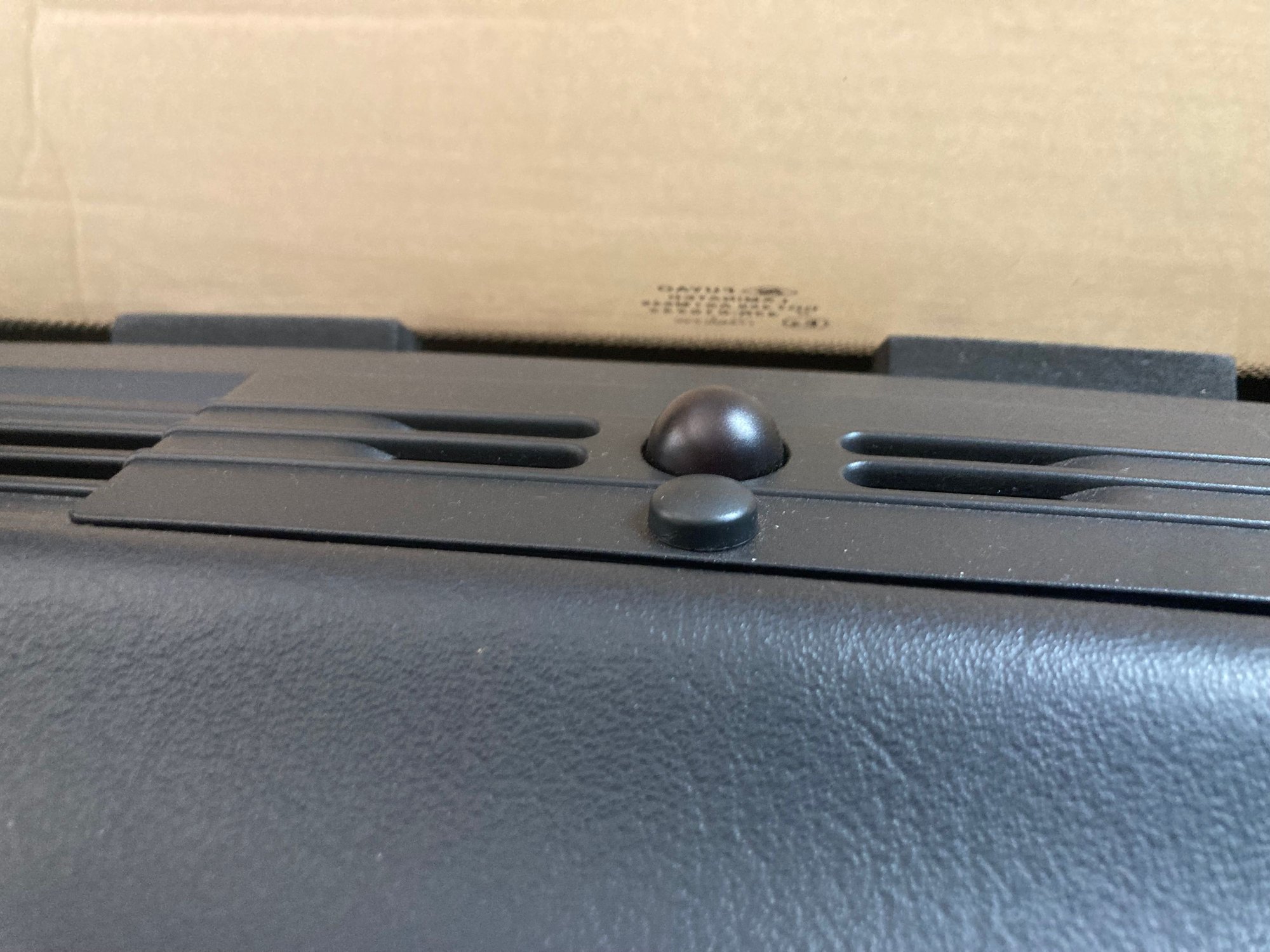

Sorted this out years ago, the problem is the gap between the windscreen and dashtop. I found coarse bitumen roads, plenty in Australia aggravated the problem.
I have inserted several blocks of suitable rubber in the space, they have been there for years and are unobtrusive. Yes, I also used rag initially.
Photo attached.
