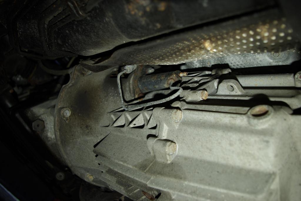

yup, check exhaust for cracks, and here's picture of my heat shield (actually, I was taking a picture of gearbox at the time) and trust me, it is quite big. Although on my other car, Focus MK2, I got rid of it, and never had any problems...

I spent some more time under the car today and there is a hole I can get my fist into on the right rear silencer. I guess I'm jst used the driving my other car which is a tuned 200SX so a throaty roar from the exhaust usually accompanies me when I drive. I guess I forgot that the Jag should be quiet and refined. Thanks for the replies anyway.
Have to look for exhaust suppliers in Poland now for that replacement silencer.
