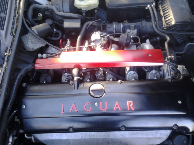

I finally got them off yesterday after like an hour and a half time spent on 2 bolts. Heres the finished product.

Old Nov 10, 2012 | 01:47 PM
mikesmith2's Avatar
Posts: 326
Likes: 63
From: Reading UK
Looks very nice

What did you paint it with, I need to do mine.

I used the dupli-color high heat rated for 500 degrees for the primer, color, and clear coat
