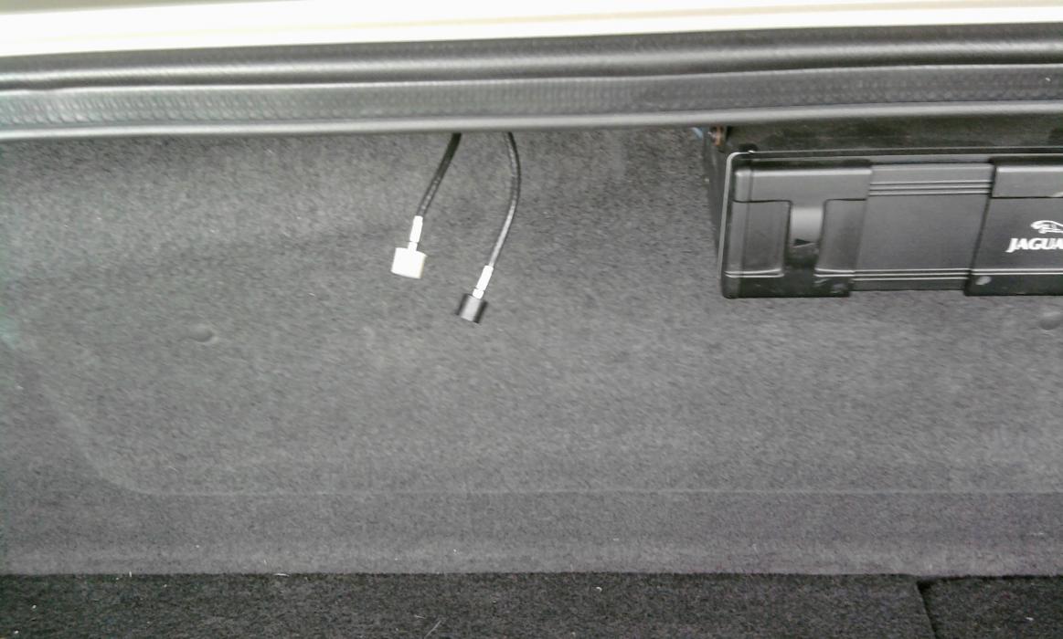

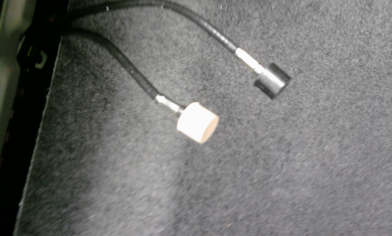

I own a 1995 vanden plas that didnt have the premium sound package. i got curious and took a look behind the trunk and saw the cut out hole was there for the premium sound sub. i was wondering are the connection speaker wires there too. i saw some wires that were capped back there. Could these possibly be the speaker leads? i took some pic if that helps. also what is the size of the sub? Did the premium package come with an amp? thanks.

Hmm...? I just installed subs in my '96 XJ6 w/o premium sound and I didn't even see those wires.

hey chavid, i don't have premium sound or a cd player in my car but I do have those wires. I do not believe they are for speakers but I guess it's possible. If you find anything out let me know.

The reason i thought it was a possibility was because they were caped and reached just to the hole where the sub would go. idk its just a thought.

Hey doug when you had your sub out did you happen to notice the wires that i asked about in my first post?
Old Jul 20, 2010 | 01:49 PM
Doug's Avatar
Posts: 25,541
Likes: 11,739
From: Pacific Northwest USA
Sorry, no. I didn't even think to look.
