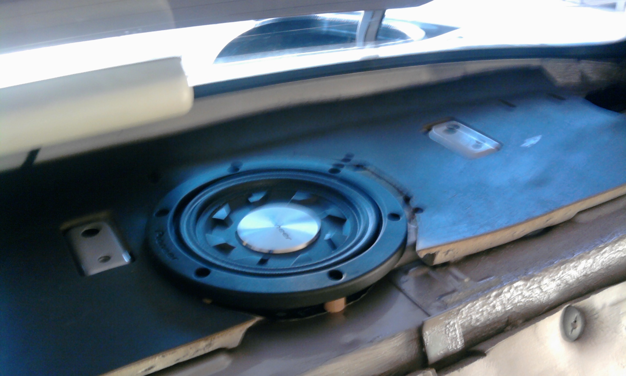

I ended up getting a shallow mount 8in pioneer TS-SW841D. i then widened the hole cut for the 6by9 sub using a dremel tool and cut some wood dalls to level it for mounting. It adds alot of bass and makes use of the stock hole where it does not take up trunk space and cannot be seen unless the rear self is out or you pull back the carpet. i love my new system! Will post pic once i put them on my computer from my phone.
My sub...

Thanks for the pics. How hard is it to remove the plastic cover that is over the parcel shelf?
You have to remove the rear seats... But dont let that turn you away. to remove the rear seats and shelf it took me about 30 min or less this being my first time ever doing it.
