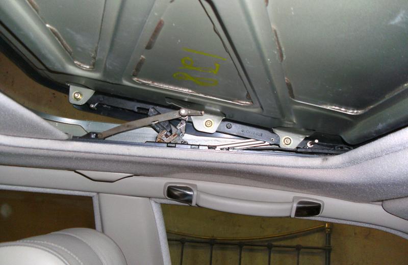

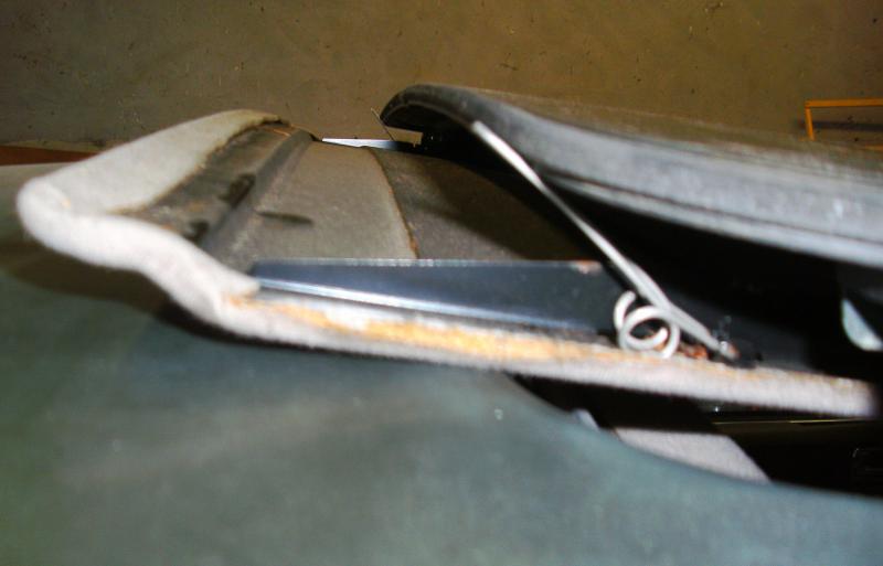

If it helps to remove the sunroof panel in order to get at the tracks etc. you will need to open the sunroof to its tilt position, so that the back part of the panel is raised above the roof line. Then the inner lining/panel can be slid out in the space between the sliding roof panel and the actual roof. It is just held in place with some spring clips. Once removed you will see the three torx head screws on either side of the panel that holds it in place. Remove these and the outer metal panel lifts off, giving access to the rails etc. Wear latex gloves if possible to avoid marking the inner lining. Refitting is just the reverse, but test it for a nice even flush fit when closed before replacing the inner lining/panel, as you may have to adjust it slightly, just by slackening the fixing screws slightly as needed. Also, its not recommended to operate the roof without the metal panel in place as apparently this can cause problems! Hope this helps. The attached pics may clarify the above.

Thank you sogood for your input.
My issue is that the sunroof was completely retracted in the open position so I am not able to put it into the tilt function.
I'm stuck bringing it forward to close it before I can tilt it.
Any ideas?
