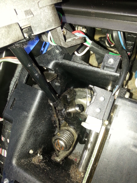

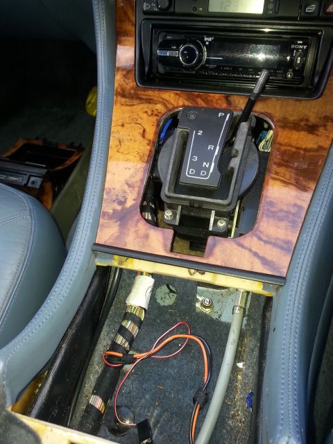

fingers crossed the cranking problem will be cured over the weekend when I get some tools of my brother and a extra pair of eyes/hands lol
in the mean time im having ago with the inhibit switch ive followed the instructions I think how do you get to the actual switch that needs adjusting? ive taken a pic of where ive got to lol and thanks for being patient

Ok, on he picture above you will see two plastic wing nuts hanging down from the inner lip of the ski slope. One will be just above the grey cable and the other will be opposite, just above the wiring loom. Undo these wing nuts and the ski slope will lift up and out. Its only held in place around the radio using Velcro, so nothing to break!
The bolts that the wing nuts screw onto may fall out, no worries, as they will simply slide back into place. You will understand fully once you take the ski slope out. By the way, this is the same procedure used to get the radio and clock out, which you may well need to do at some time, due to high failure rate. Oops, just noticed that you don't have the stock radio! You will see the various screws holding them in, after the ski slope is removed.
The micro switch in question will be clearly visible on the right hand side of the shifter. That's on a right hand drive but I think it's the same regardless of where the steering wheel is.
You'll see the little metal tang that activates the switch, move this back and forth, gently and listen for the switch clicking consistently. Clean, as mentioned and adjust as necessary.
Remember, this is a possible cure for a non cranking "dead" car. If it's turning over but not starting then your problem lies elsewhere.

quick update looks like the switch has been adjusted before as the 4 Philips screws were a tad chewed up ive fiddled around with it but its still the same to be honest wiggle the shifter for it to light up red
pic abouve to show you what it was like
