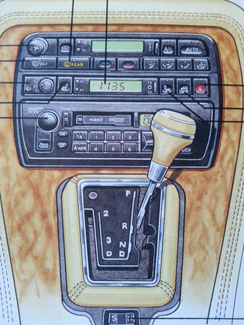

Update regards the P lighting up it still does if jiggled a bit for it to stay on to start the car, the only light to come on without jiggling is the R, the N or D don't light up at all however once selected to the left hand side the DD 3,2 all light up not sure what these are actually for as not had many automatic cars and I have not got the owners manual

the white plastic bit that slides I found if I apply a bit of pressure pushing it down a bit it will light them up but I can't see anyway of adjusting that part, the black bit with the metal prong ive bent that slightly and you can hear it clicking on to the tiny switch once pressed it does seem that it needs to be moved upwards a bit the whole thing if that makes any sense? as mentioned as soon as the shifter is to the left hand side all lights work are they for when your towing something by the way?
The shifter layout, often referred to as the "J" gate, because it's shaped like the letter J, allows normal automatic operation on the right hand side.
The left hand side shows 1, 2, 3, for the relevant gear. If you select 1, then the car won't shift beyond first gear, so yes, useful for towing or whenever you need torque without acceleration, likewise with second gear, say pulling a caravan uphill. Normally you might accelerate to get a run at it, but if it does what it's supposed to do, as an automatic, it will go up through the gears as the revs/speed increases, thus losing pulling power.
You can drive as a manual in effect by using 1, 2, 3. With regard to the dodgy switch, keep fiddling and see if you can wedge a packer, plastic or card into the relevant area. A bit obscure I know, but once you've recognised the cause, a cure is a lot easier. You're getting places, well done!
