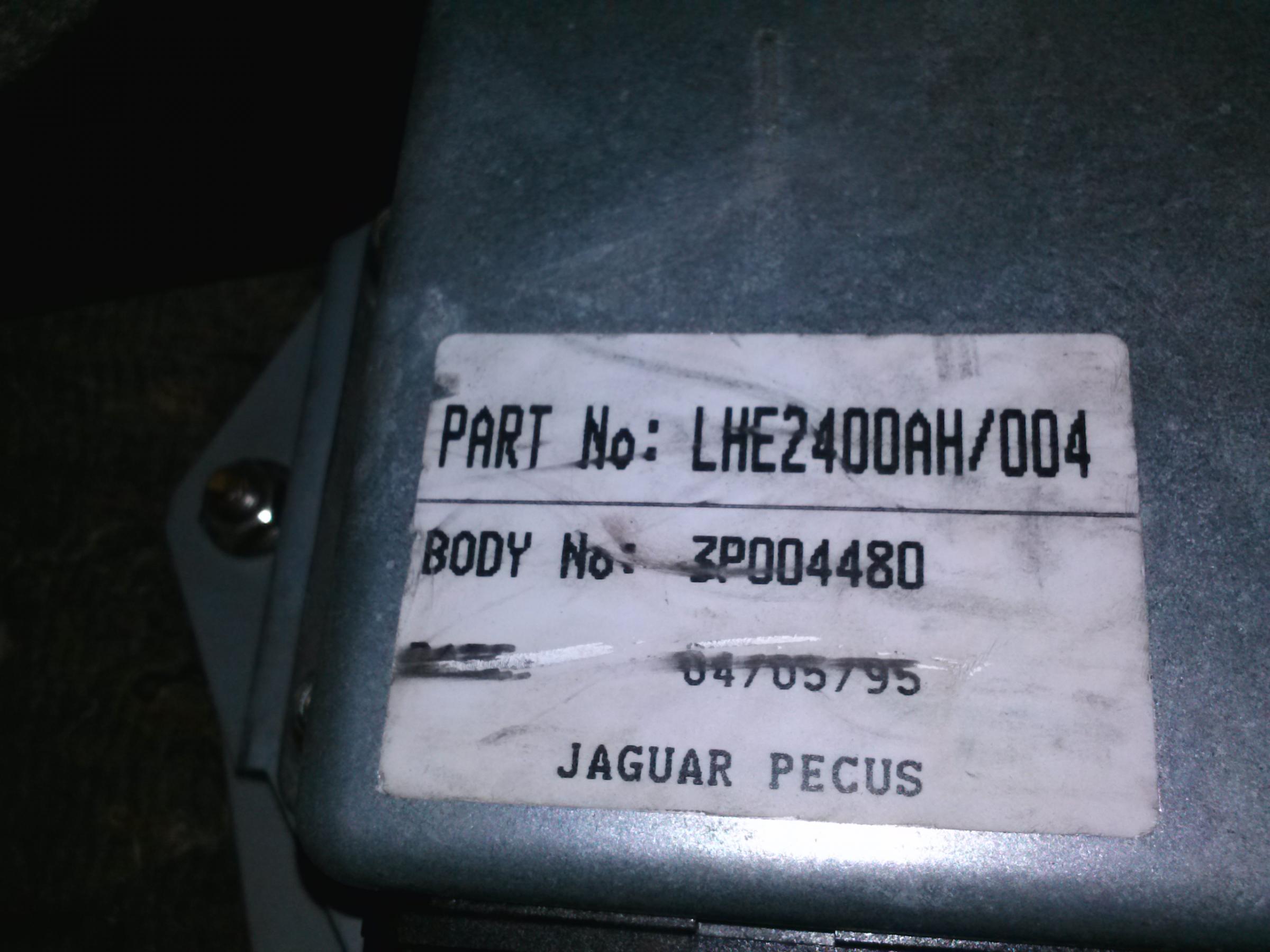

If the part# on your TCM matches the replacement, no problem. But why are you going to replace yours?

I'm no expert but I think the "/004" that you see after the part number on the Pecus TCM (but not the Bosch) is significant, representing the specific programming map.

Pics from the unit on my car below.
Thanks so far doug
Attached Thumbnails TCM compatibility-cam00085.jpg   TCM compatibility-cam00086.jpg
