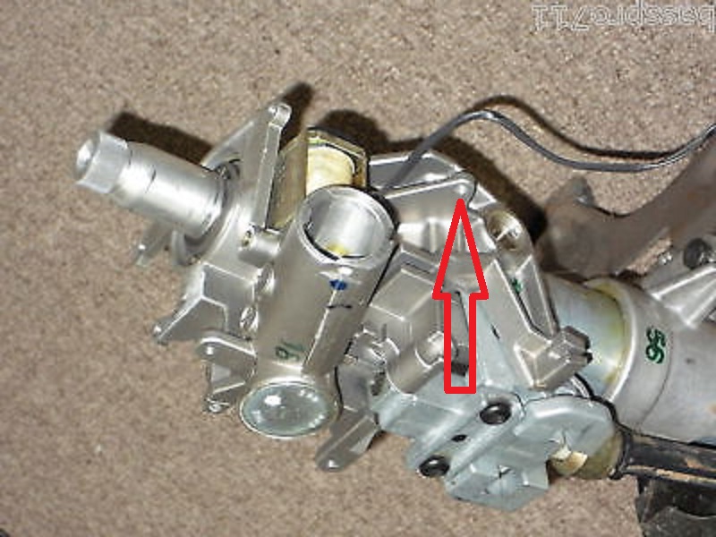

I looked at it closer as I have the bottom half off . There are 2 philips screws holding the top in place . Yours is probably missing as I assume the spacers or bushings between the top plastic and the metal mount holes of the center metal column assembly . The screws are located left side straight above the black cap covering the red ignition switch .On the other side of the metal key barrel the right screw is straight above the small mounted speaker behind the speaker magnet edge . I'm not going to take mine off at this time but I assume there are spacers involved to get it to set correctly . Get different sizes from the hardware store and return what you don't use
Your screws are probably missing so I'll pull one and measure . Gotta run an errand so later tonight

.......ummmm.................wel l..................I don't know how to say this ........... .............I was wrong as there are 3 screws metric M4 - 0.70 thread pitch about 1/2 long , no spacer . The 3rd one is 2 inches aft of the left side one . The big box hardware stores don't always have as big of a selection as the independent store I go to . The pic is for the right side of someone elses pic

By lifting the top column cover up you can better see the area of interest as you feed the screw through on the forward left side . Once you tread and fix that position you can rotate the plastic around that axis and the other 2 will fall in line . Now you know why yours was loose and they punted the hardware , amateurs .
