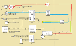

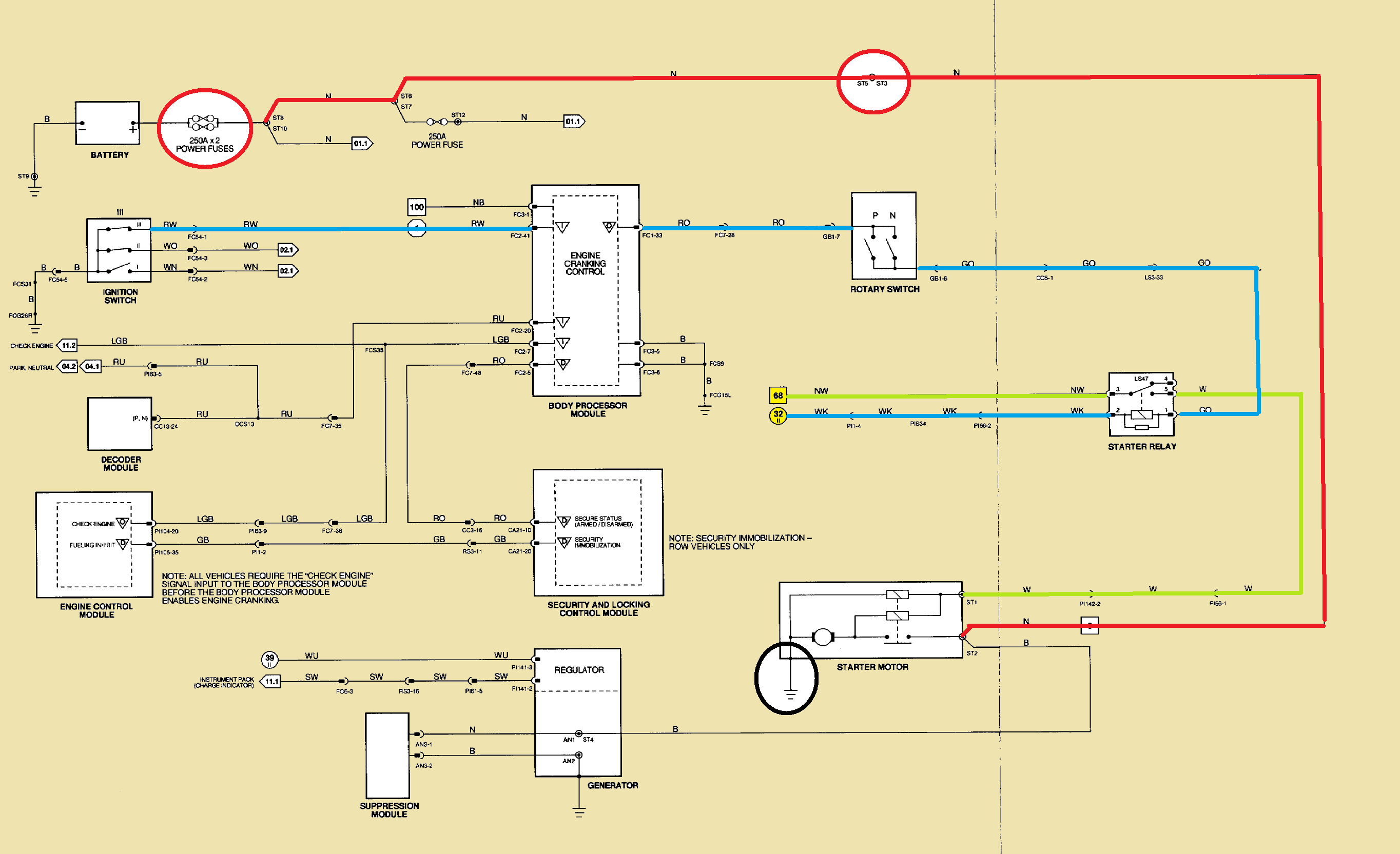

Put your finger on the starter relay and see if it clicks , if it does swap relay with the fog relay . Did you disturb the blue connector that mounts to the mini wall on the left side that is the ignition switch connector that needs a good ground on the wire at pin 5 toward the car side . Mine was corroded at pin 5 in the connector . The starter motor only is on pin 1 .
The new steering column may be at fault with the extend mode and you can swap back and see .
Attached Thumbnails Tilted Steering Column-x300-starter-circuit.png   Tilted Steering Column-x300-smog-relay-g.png
