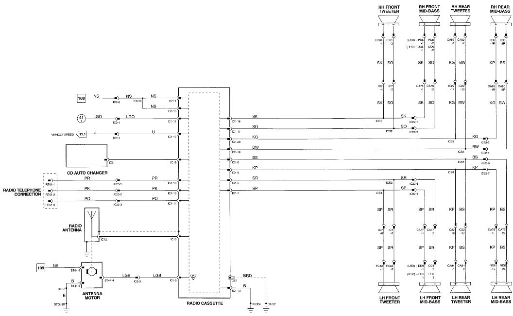

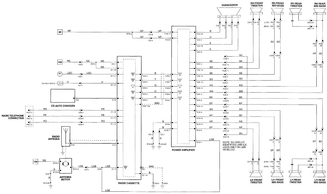

So the premium has a total of six tweeters in the front? I don't think that is correct.
I had my door apart (non premium) there was no evidence of a tweeter "located behind the black plastic door handle cup".
And the wiring diagrams show no more than 4 tweeters total in each setup.
Standard:
Premium
Jaguar documentation is very confusing.

You're right, there are no tweets in the front doors, only the pillars and defrost vent. There are tweets in the back doors though and on the back deck behind the seats, I think.
