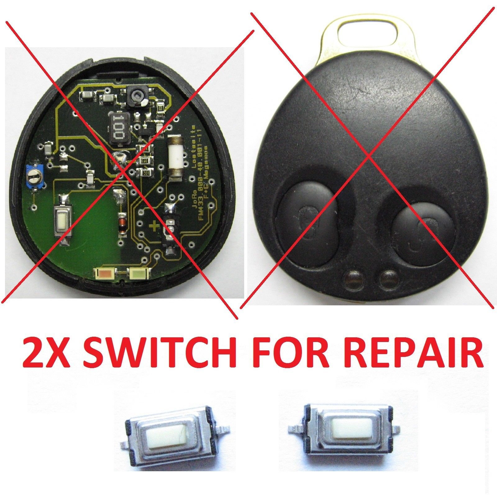

First off, my remote key fob has finally given up the ghost after a period of intermittent operation. I took it apart and found that the tiny little microswitch on the "lock" button seems to be stuck in position. The "unlock" button sticks occasionally and stays on, which upsets the whole sequence. Attempts at cleaning/freeing haven't helped, so I'm looking for a (budget) replacement.

The switches : have you sprayed with some penetrating oil ?
micro switch for repair remote alarm key fob jaguar XJ6 XJ12 XJR X300 saab 9000 | eBay
British whole units so frequency may match : note the hint on the Saab
http://www.ebay.com/itm/JAGUAR-XJ6-X...QAAOSwdmpZ4JFS
5 of them that can be repaired and put back on the market and pay dividends :
http://www.ebay.com/itm/JAGUAR-XJ6-X...gAAOSw90lZlvmQ
Can't find the button covers .

Button covers are available direct from Jaguar Classic Parts for small money (I bought 2 sets last year as I'm sure stocks will dwindle)
https://www.jaguarclassicparts.com/uk/part/JLM20626

FOB button covers
Jaguar XJ, XR, XJR,XKR remote key fob Silicone Repair Buttons | eBay
