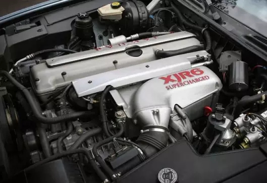

You'll have to check under the bonnet for sure, but in short, the XJR has a supercharged engine, modified suspension, and usually 17" wheels.

As noted above, the primary difference between a non-XJR and XJR X300 is the supercharged engine. That's the easiest and most obvious difference that can be verified by simply opening the hood
