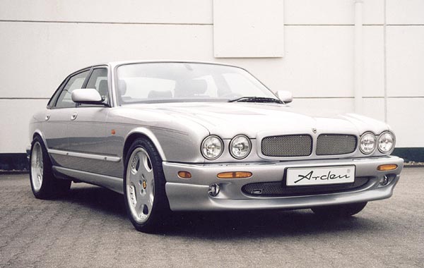

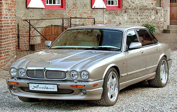

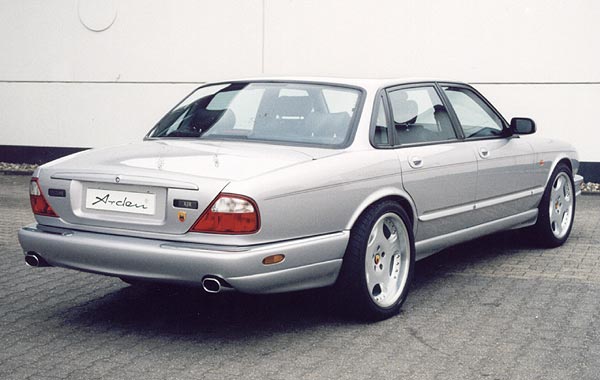

dpena's Avatar
Posts: 28
Likes: 9
From: San Jose
Thumbs up
I really like the sport look of the Arden wheels:
