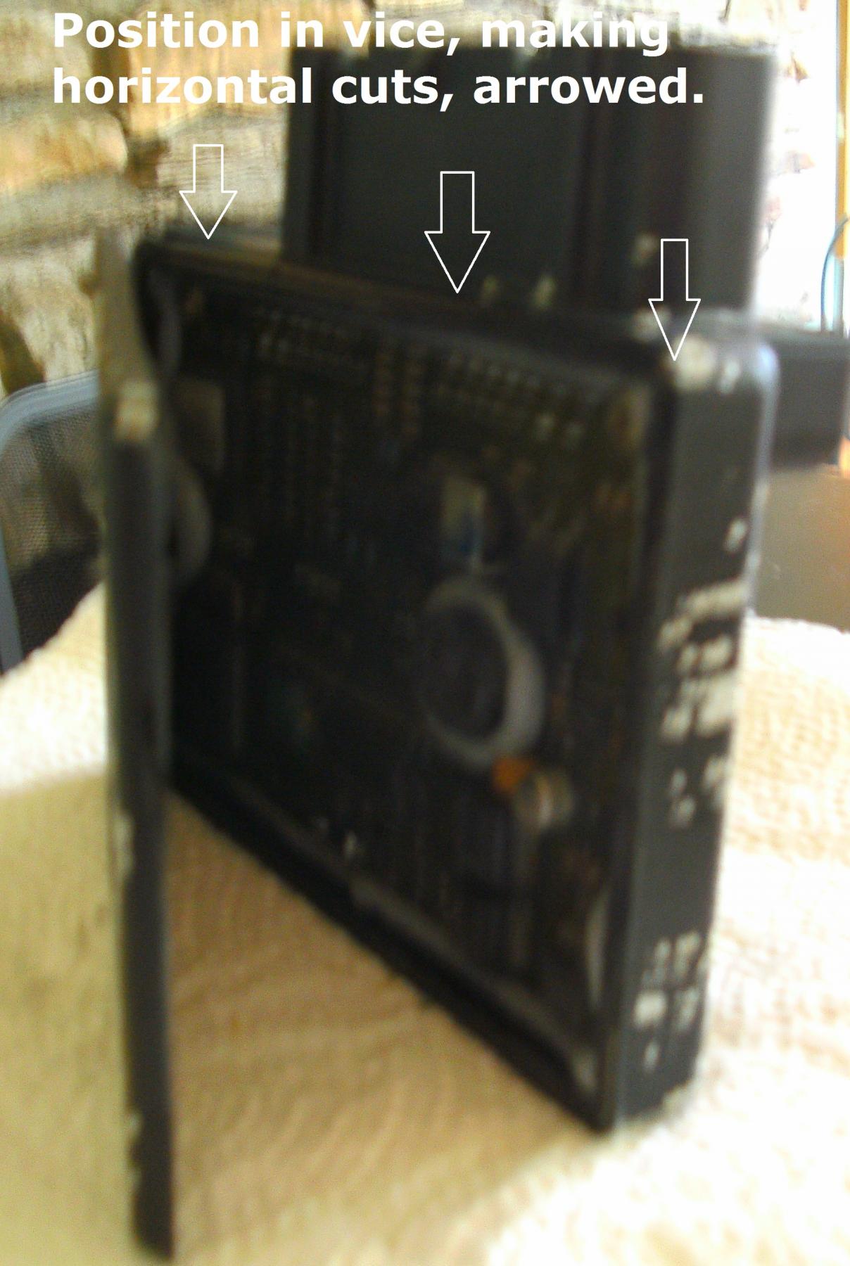

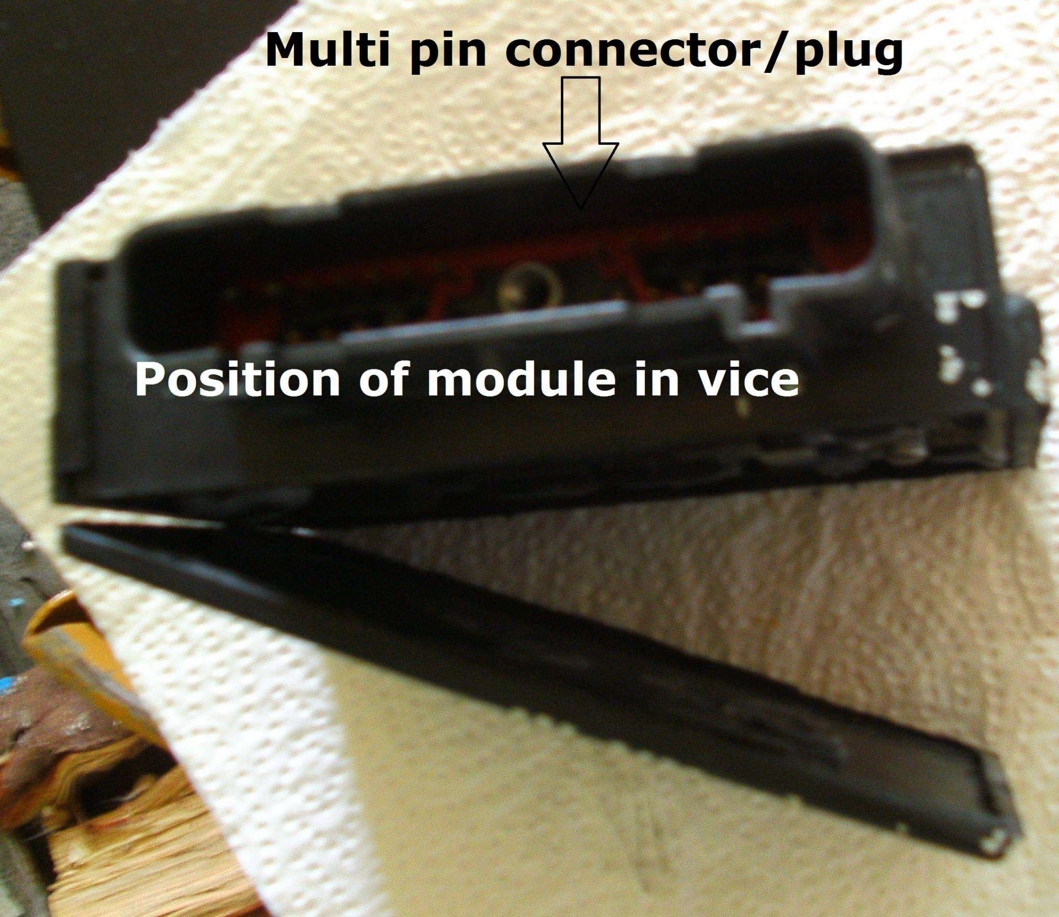

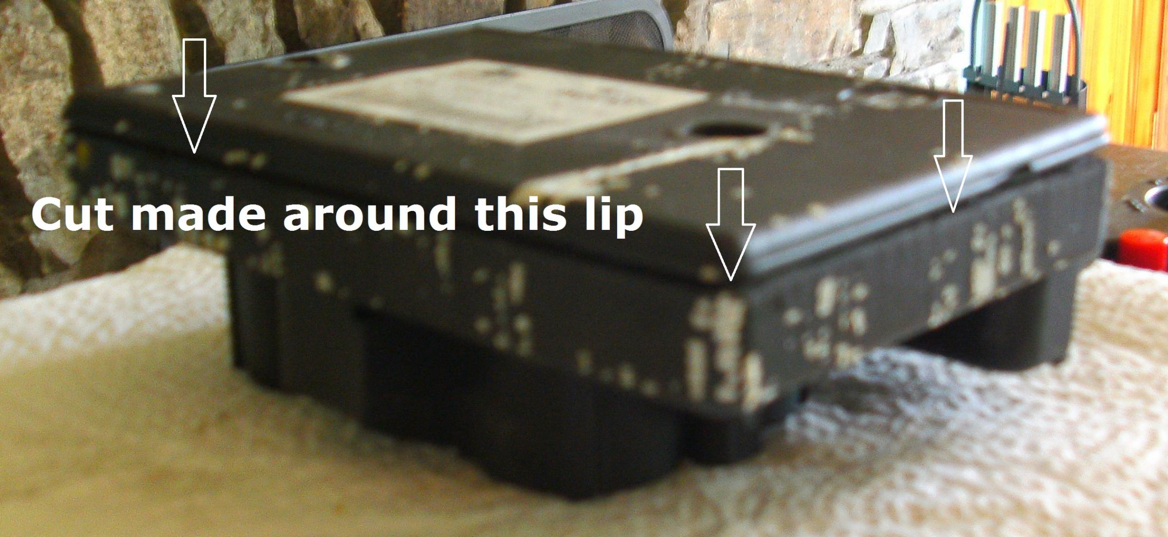

As I understand it the module has to be cut open with a dremel. Is there a write up on that so I know where to cut etc? I just don't want to damage the board or other components in there and end up having to replace it.
I've found a couple images that show the inside, but not where they cut...sometimes it's hard to tell with pictures.
Old Apr 23, 2014 | 05:01 AM
sogood's Avatar
Posts: 948
Likes: 317
From: Ireland
When I opened mine, I placed it in a bench vice, wrapped in some soft cloth. Tightened it up just enough to hold it snug. I placed it on "edge" so the top and bottom of the module were sat against each of the vice jaws. I used a junior (small) hacksaw, cutting along the bottom of the lip, formed where the top of the module would have been pressed on originally during manufacture.
I kept the saw very level/horizontal, so that it cut through evenly. I turned the module around, cutting each side in turn. The blade never got too near to anything inside, as there is a bit of clearance inside.
Attached pics may help to clarify.
