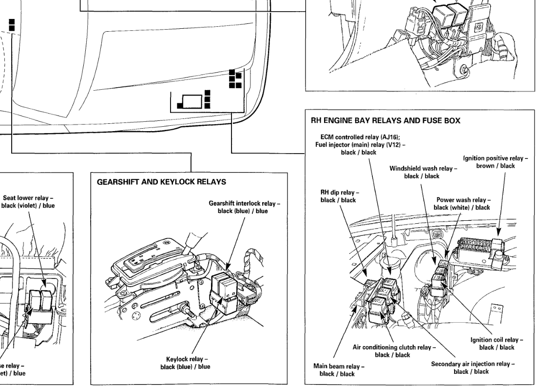

Hi Hege72,
All six fuel injectors should receive battery/alternator voltage (12.6 - 14 volts) on the Black wire with Light Green tracer line. These wires all connect to the ECM Controlled Relay. To test the voltage at the Black/Light Green wire, with the ignition ON or engine running, put one of your meter test leads on the B/LG wire and the other lead on a good ground (not the other injector wire). If you measure across the two injector wires, you will be measuring a very small AC voltage.
To pulse the injectors open, the ECM connects the other wire at each injector to ground (Black/Blue, Black/Slate, Black/Green, Black/Red, Black/Orange, Black/Purple).
You can download the wiring schematics at this link:
Jaguar X300 Electrical Guide 1997
If your meter has a Duty Cycle setting, you can assess whether or not the ECM is pulsing each injector equally.
