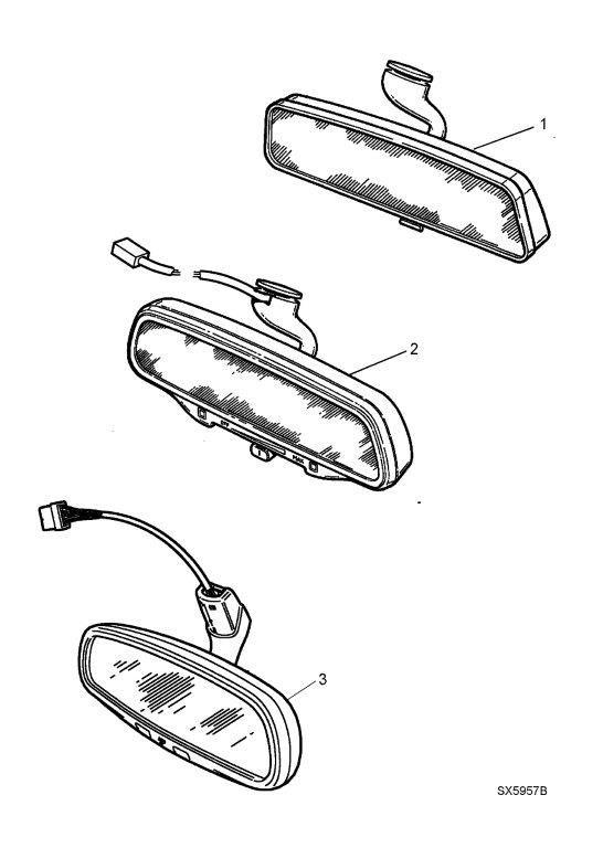

ok looks like my rear view mirror is different and it is the model n.3 in this schema.
looks like it is not interchangeable with model n.1 as I wanted. Anyone can confirm ?
thanks

My production car # 755xxx has item # 3 and there are different removal procedures for both
https://www.jaguarclassicparts.com/u...ar-view-mirror

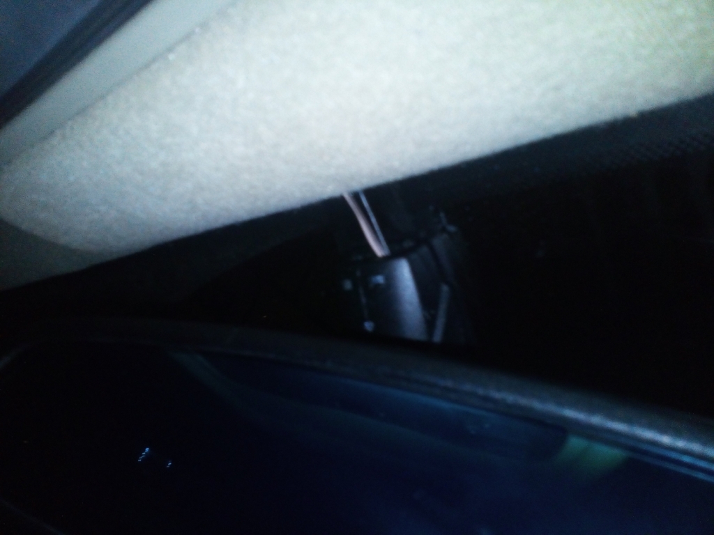

I think that to be 100% sure I need to remove the courtesy lights holder, and there should be the rear view mirror connector inside to see if it is 3 or 4 pins. Only thing is that I'm afraid to break something in the process of removing it. In the video above in this thread it is unclear to me how to remove it properly.

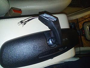

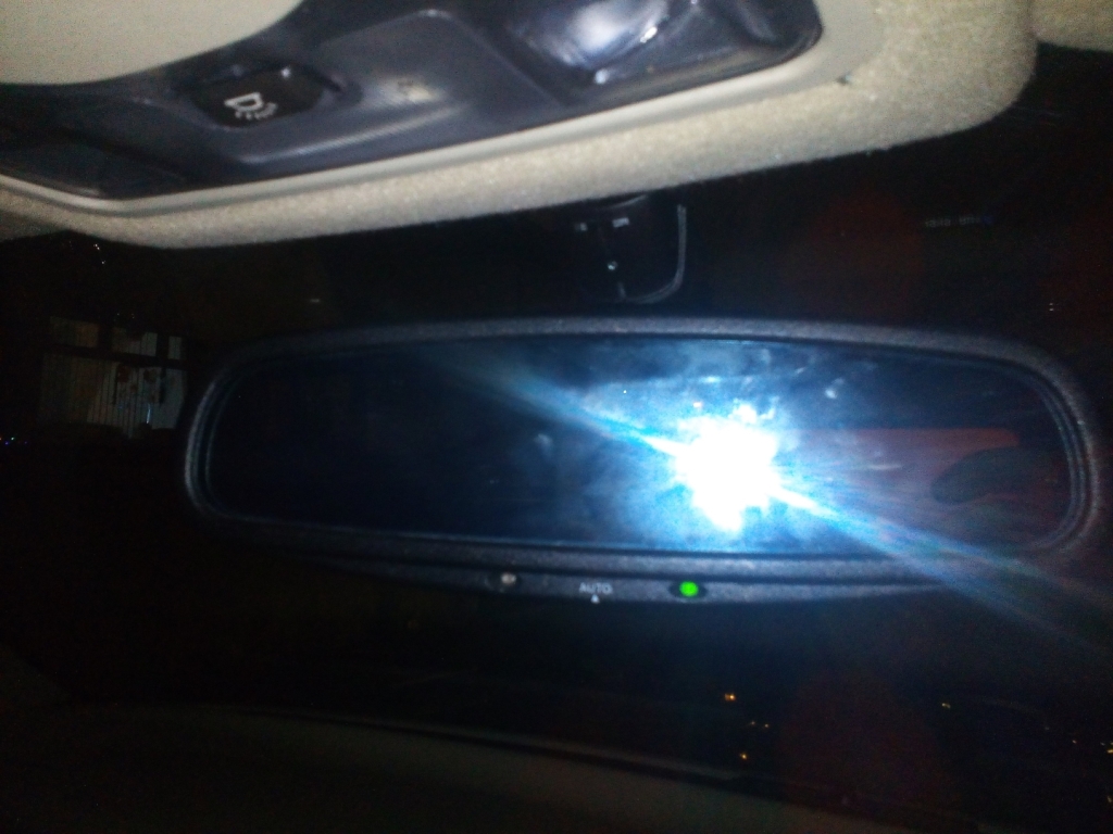

If you have mirror no3 then you need eBay item number:263071088851 if you want to go the manual mirror way.
To remove your mirror you need to pull downwards in parallel to the windscreen. Just remember to keep it in the same plane as the screen, there is a little metal clip that holds it up to the mount thats glued to the screen.
Alternatively if you're still unsure how to, you can always pull the mirror itself from the ball mount, just push off the metal ring with a screwdriver and pull it off, you can see the metal ring in the attached pic. Then you can cut off the cables going through the ball and push the manual mirror onto the ball mount(manual mirror don't have a metal ring clip, it just pushes in/out).
The mirror socket under the courtesy lights will have 3 cables, 12v, ground and reverse lights switch off.
Attached pic is the citroen C8 mirror, its exactly the same as Jaguar one, just with a shorter cable, that you would have to wire up to your original mirror plug. I've fitted it, few days ago.
Attached Thumbnails X300 rear view mirror-img_20171220_185250.jpg   X300 rear view mirror-img_20171220_194909.jpg   X300 rear view mirror-img_20171220_194918.jpg

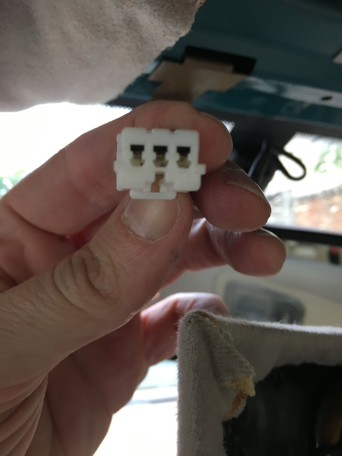

ok today I looked at the connector. It is 3 wire connector so should be model n.2. But the mirror looks like the same as model n.3 in the schema above, so I am more than confused now. Here is a picture my the connector.
Just to be clear it is the same connector of this picture below but the mirror is totally differentmine is the same as shown by katar83.
Shouldn't it be 4 wires connector ?
