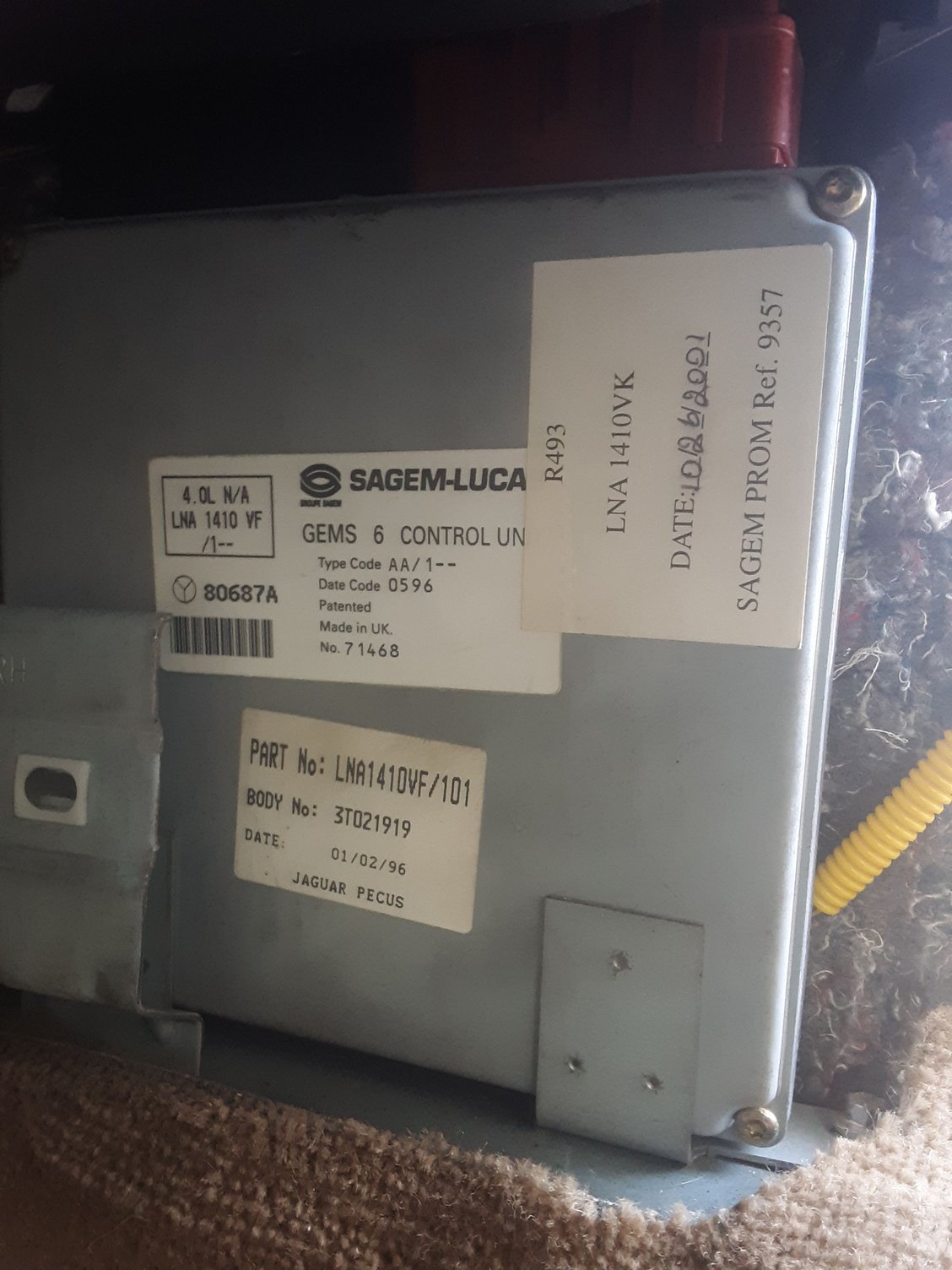

Here's a pic of the ecu. It does not have the traction control modules.

You have the R493 updated ECU so the last step would be if you have the EGR part # specified in the TSB
I don't see the dedicated ground wire on the bottem mount bolts attach points
The parts may have come from a donor car in the past so you can have a mix
Wether a modded ECU can correctly control a factory original; EGR is a question
The return spring would be hard to tell

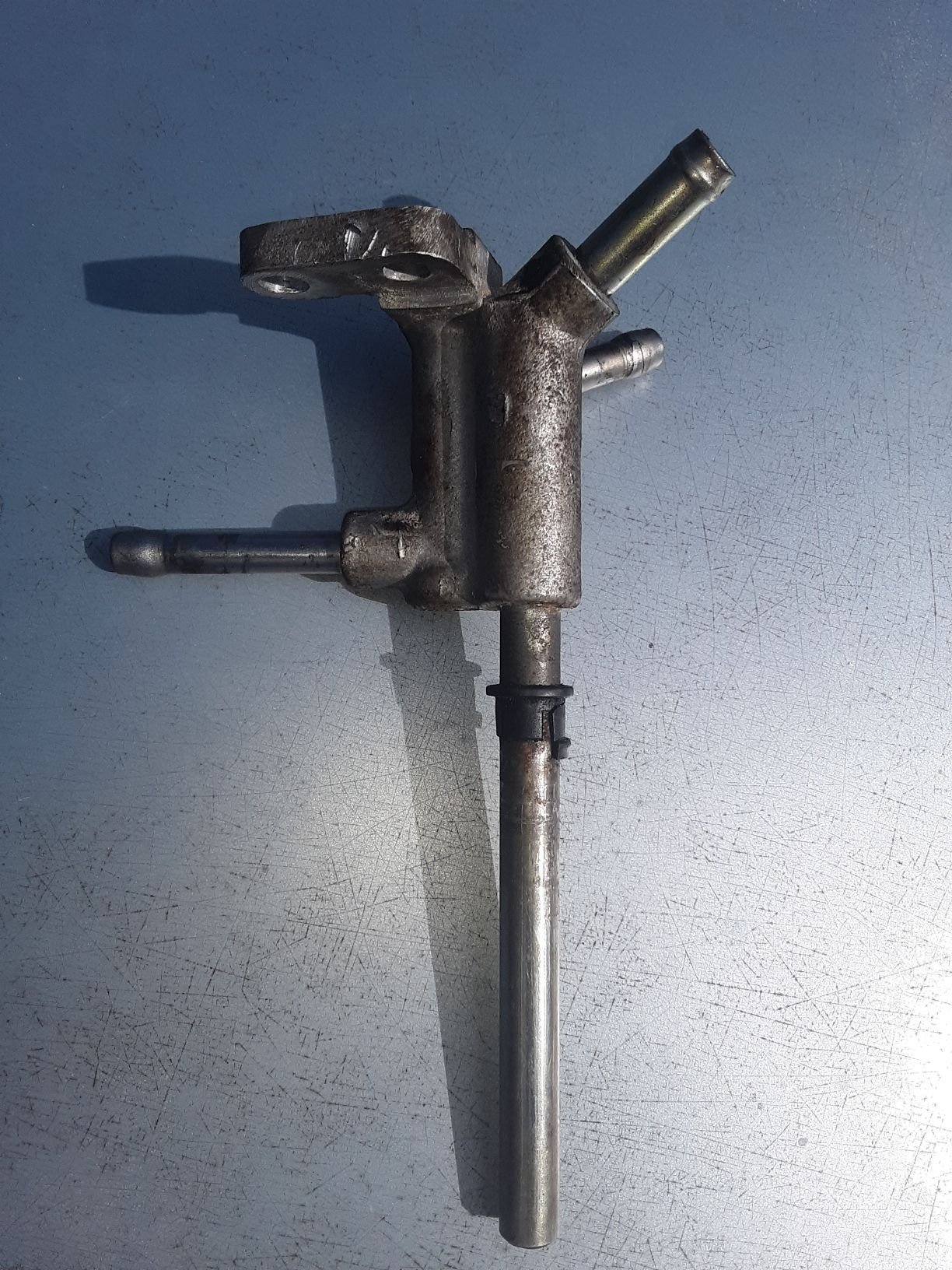

What does this specifically do? I see it has both water and air going through it. Is there a name for it?

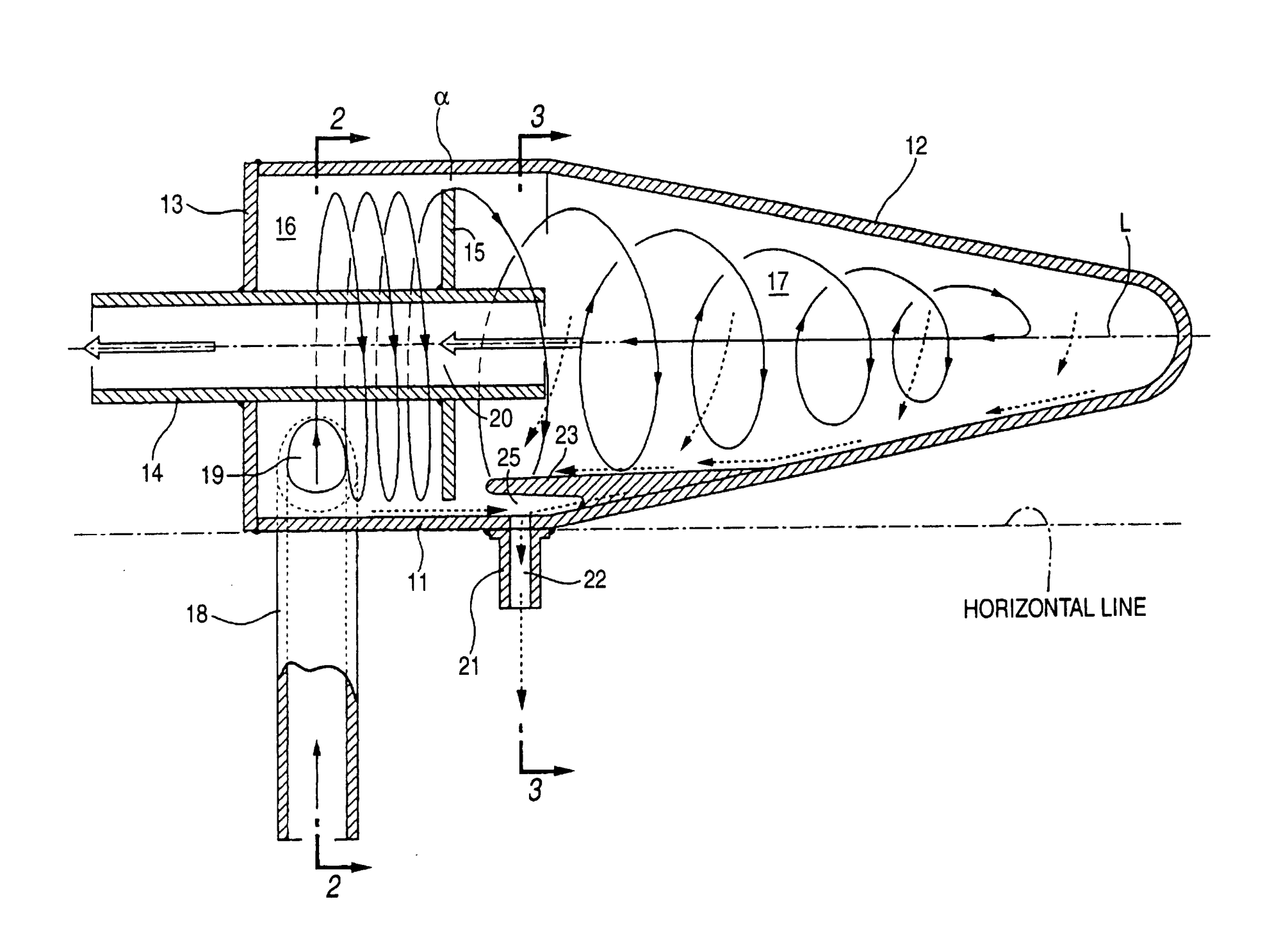

There was some modifications to clean the crankcase breather air of oil particles that foul the TB and the butterfly freely moving back to the idle stop
This free movement defiantly effects the X300 idle smoothness from reading
It would be a centrifugal force separator
The factory separator design is contained inside the valve cover and is of poor performance
Spoiler

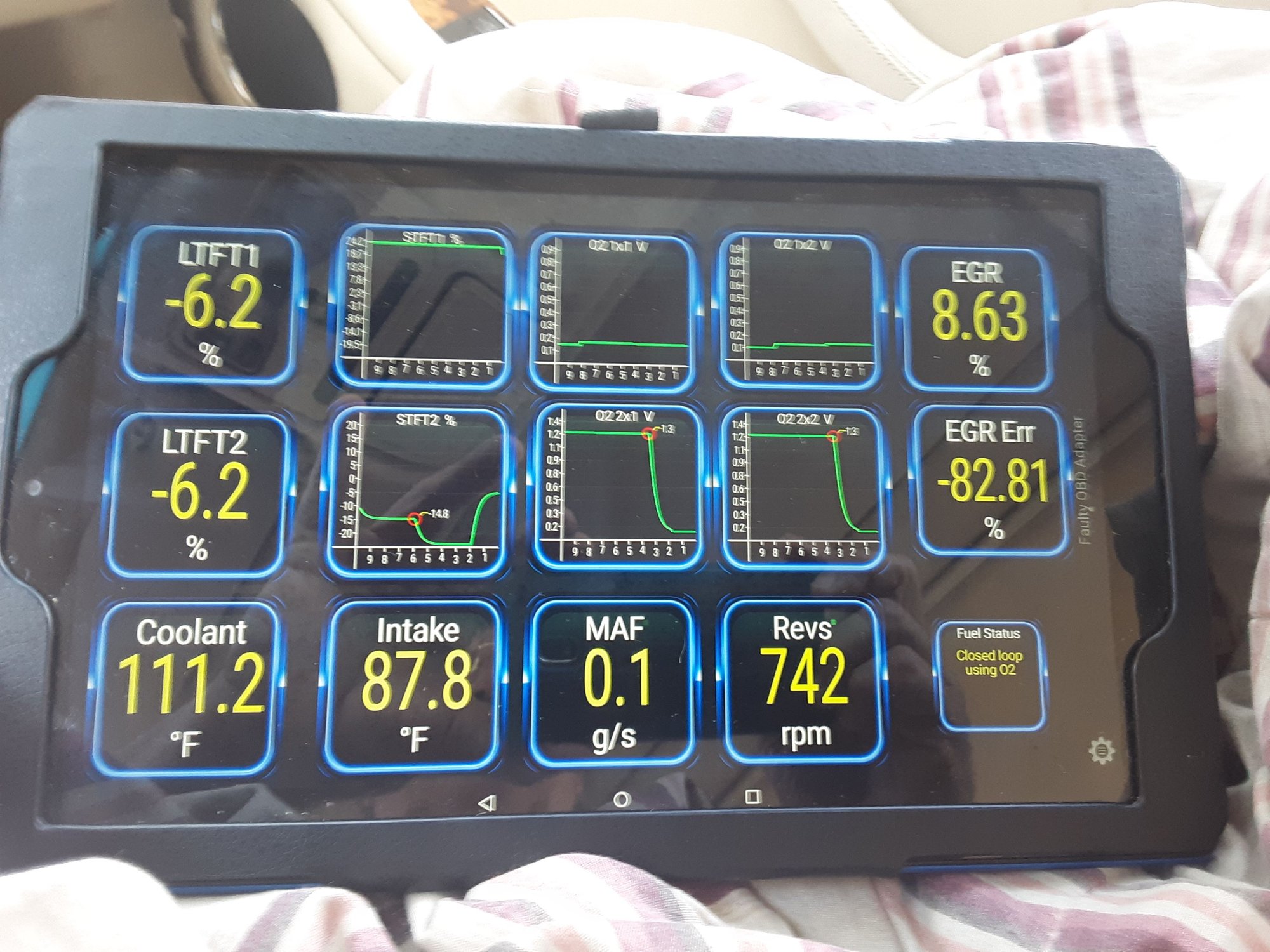

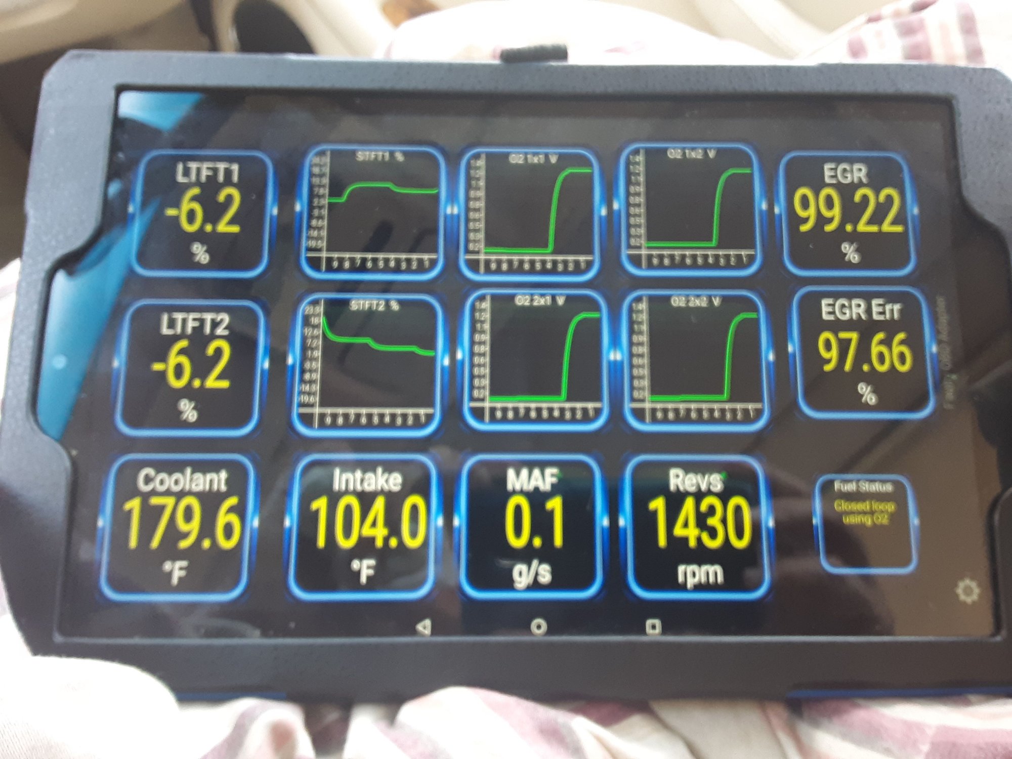

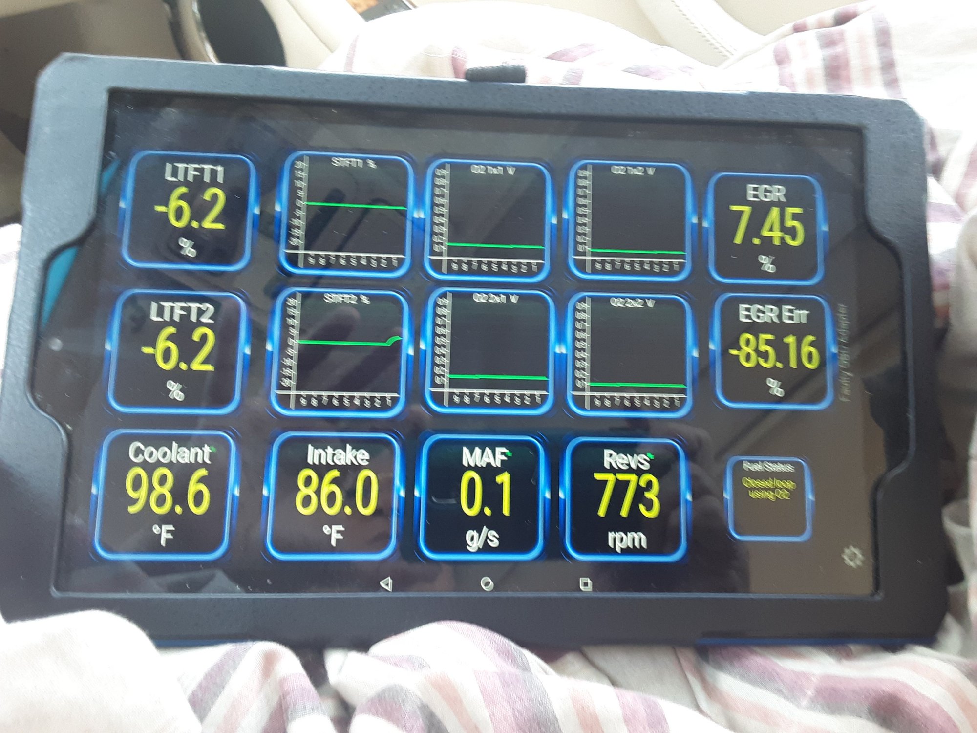

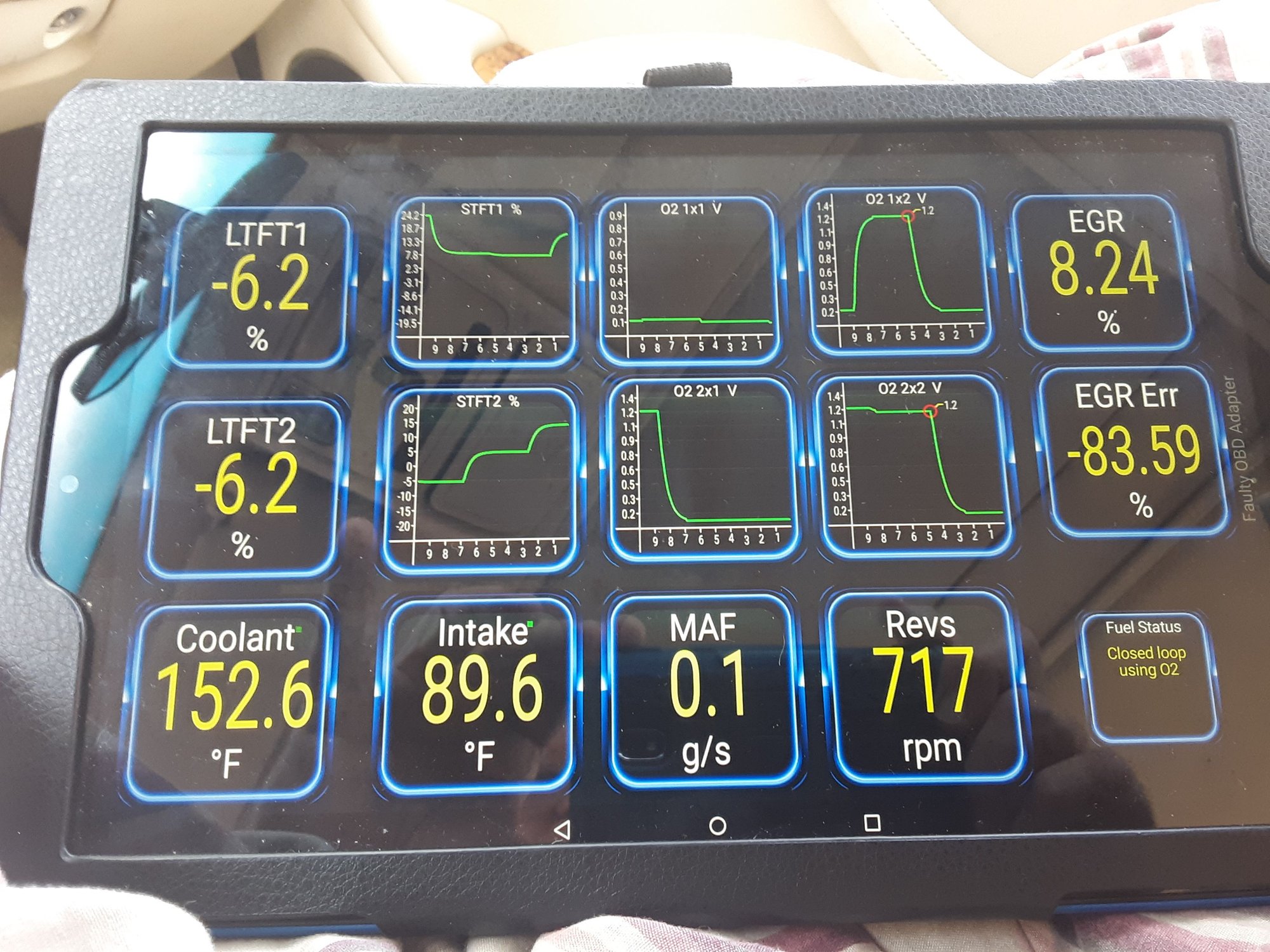

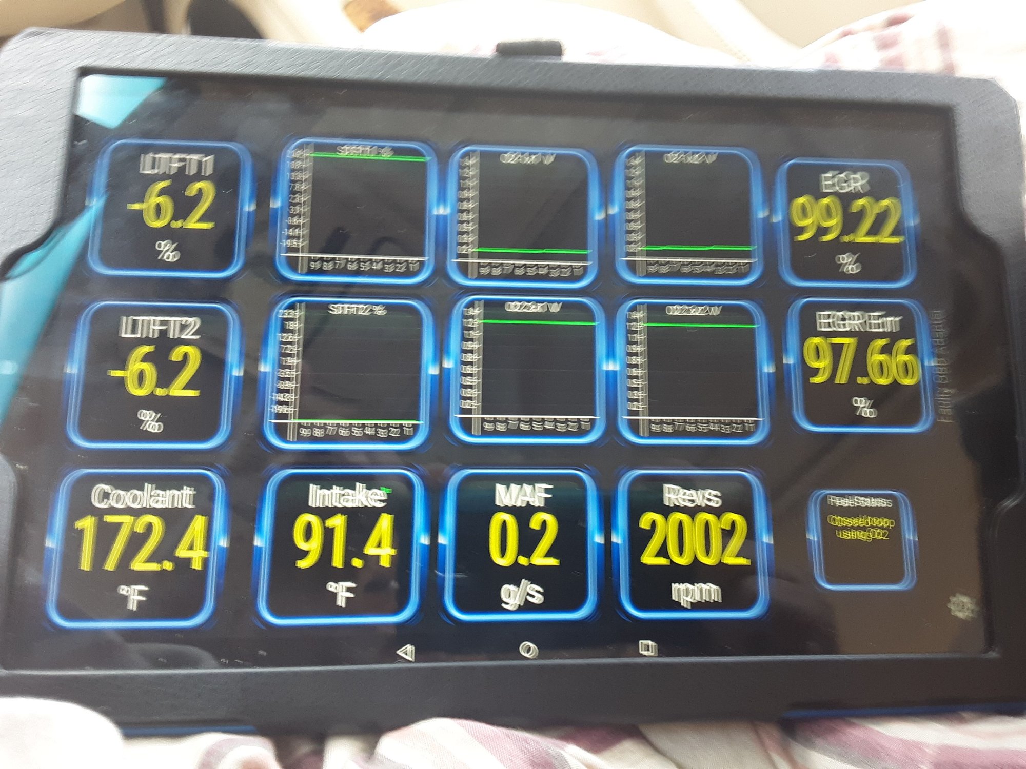

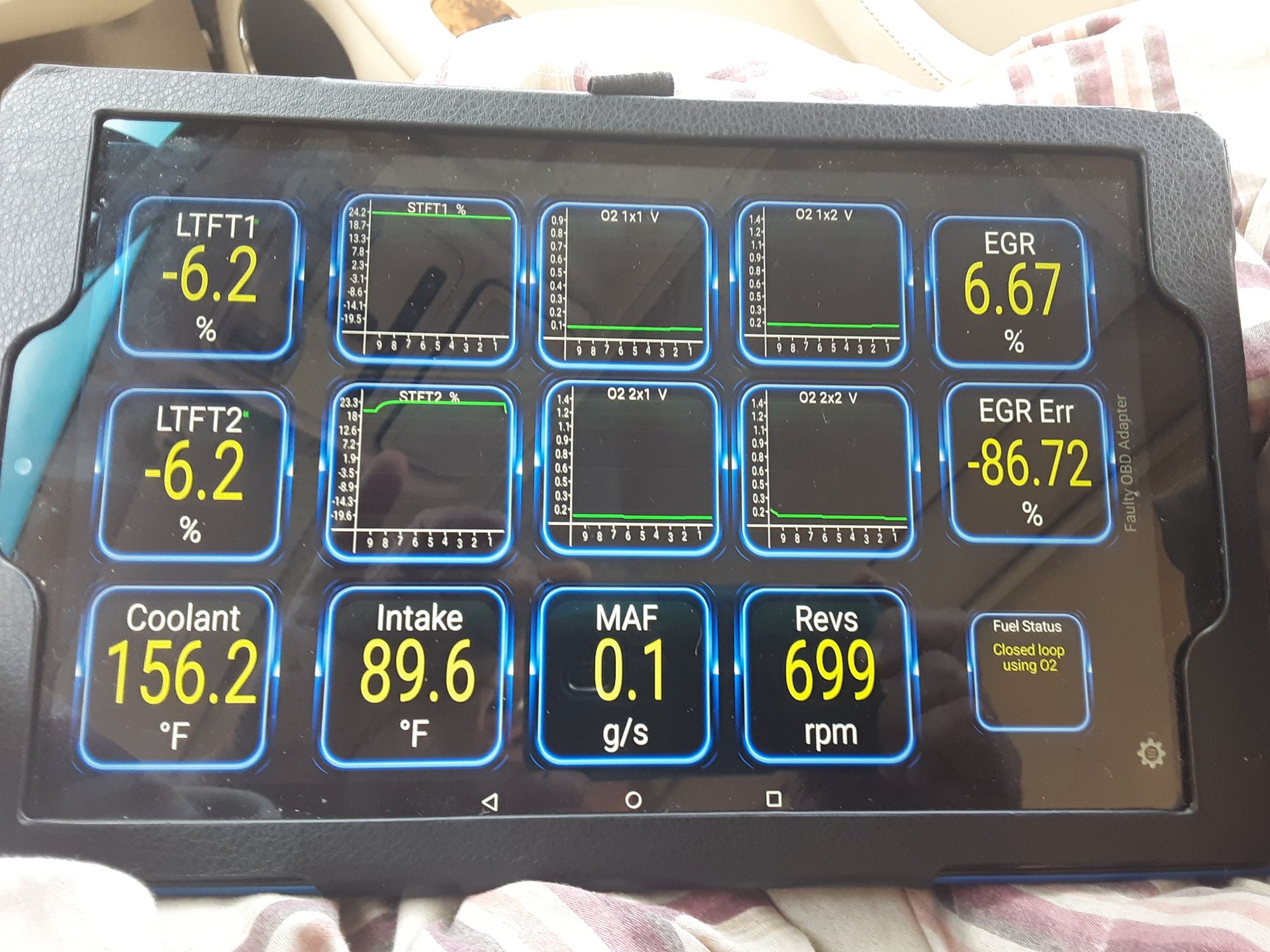

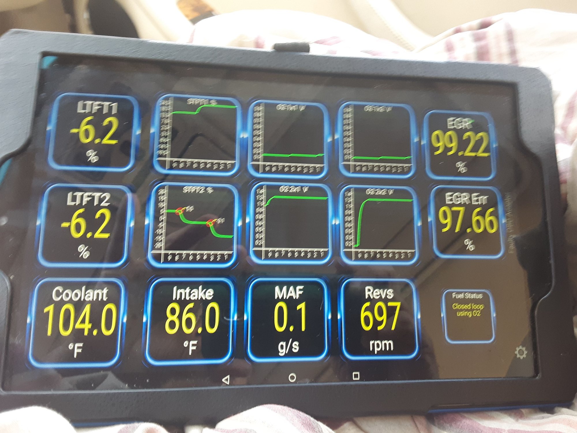

Using cheap ELM - 327 rip off reader and Torque pro android. Tried taking pics at idle and after running around 2000 rpm for 30 seconds (ish). The bank 2 O2 sensors jumped around quite a bit, usually together. Which I suppose goes along with the p1314. We're assuming an air leak into bank 2. Bank 1 sensors remained low on the graph most of the time. When I accelerated sometimes all for sensors jumped. Sometimes only the bank 2 sensors jumped. I'm wondering if the cheap obd2 reader wasn't updating properly at times. Or maybe an issue with the bank 1 sensors? I did notice the egr was getting commanded erratically. Sometimes it was down at idle. Sometimes it was up at idle. Pictures yet to come.
Old Oct 7, 2021 | 02:15 PM
  #54
BobbyDing's Avatar
Joined: Aug 2018
Posts: 214
Likes: 58
Recently started. Temp low, high idle. Surprised it was already in closed loop.
have to post pics seperately as my phone is struggling to post them. I'll say when the last pic is posted. There are several.
Old Oct 7, 2021 | 02:22 PM
  #55
BobbyDing's Avatar
Joined: Aug 2018
Posts: 214
Likes: 58
Idle is about as low as it gets (maybe a little lower. We'll look at that after we get the p0300 fixed). EGR?? Bank 2 O2 sensors jumping.
Old Oct 7, 2021 | 02:25 PM
  #56
BobbyDing's Avatar
Joined: Aug 2018
Posts: 214
Likes: 58
Temperature climbing. O2 weirdness.
Old Oct 7, 2021 | 02:27 PM
  #57
BobbyDing's Avatar
Joined: Aug 2018
Posts: 214
Likes: 58
More O2 wierdness.

Old Oct 7, 2021 | 02:32 PM
  #59
BobbyDing's Avatar
Joined: Aug 2018
Posts: 214
Likes: 58
Holding around 2k rpm.
