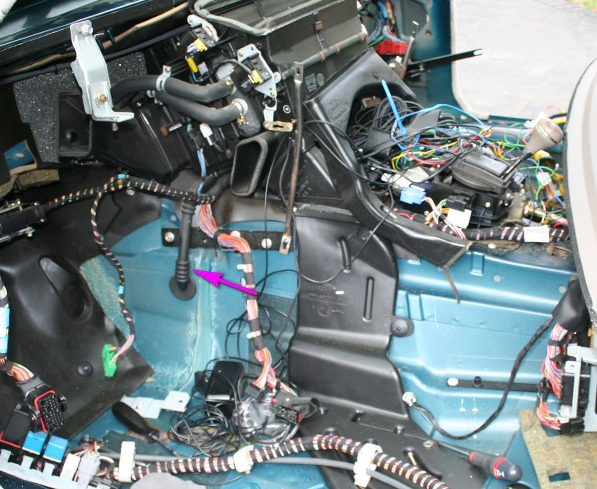

2 - Air Con condensate overflow. There is a drain on each side of the heater/air con unit that can become blocked. If you never see puddles of water under your car in that area then they are likely blocked and causing condensed water to build up and overflow in to the blower units.
This is the drain tube you are looking for
Don't worry - no need to remove dash to get to this! You may need to remove some bits of trim and or glovebox and pull back the carpet. Remember one each side.

Do you have a pic of the right side ?

@LadyP - this is the best picture I have of right side. Hope it helps.

Yes , I was interested in the cabin air plenum valve motors .
You went in deep
