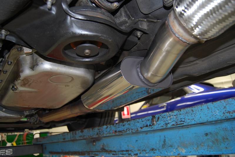

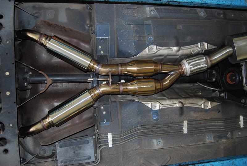

I have had my ECU remapped by XJR engineer for quite a while now 20,000 k,s to be exact it has brought the car into the 21st century very well
I also have a full headers to tailpipe system cold air induction and Johnson inter-cooler pump and XJR engineers front sway bar links and 3,58 diff gears my car is probably the the fastest XJR I6 in Queensland since the mods
I have consistently seen higher top speeds better economy better city driveability and no embarrassment against BMW,s or Benz,s either
just astonished looks from those drivers
You can ask Andy a million questions but my car is the proof of the pudding his stuff works and works well if he lived in Australia I would be at his place just to see what he comes up with next for these cars
If it hadn't been for his invaluable input over the years I would have scrapped this car years ago
I have tried to upload the dyno video but the file is to big the look on the guys faces when we put my XJR on the dyno was priceless
Attached Thumbnails XJR6 Engine ECU Successfully Remapped-dsc_0033.jpg   XJR6 Engine ECU Successfully Remapped-dsc_0096.jpg   XJR6 Engine ECU Successfully Remapped-dsc_0098.jpg

@doc
What are those bronze coloured cans to the rear of the flex section?
The exhaust note must be really sweet.

Originally Posted by plums
@doc
Hi Plums they are the catalytic converters
My model XJR has a pair oxygen sensors up front
I wanted as long as possible pipes from the headers before we bridged it into 1 pipe then splitting it to make the back spit section even length
The cats are High flow metal substrate 200 cell cats just legal over here when you hold them up to the light you can almost see through them the 100 cell cats you could see more light
I wanted the car legal if possible
