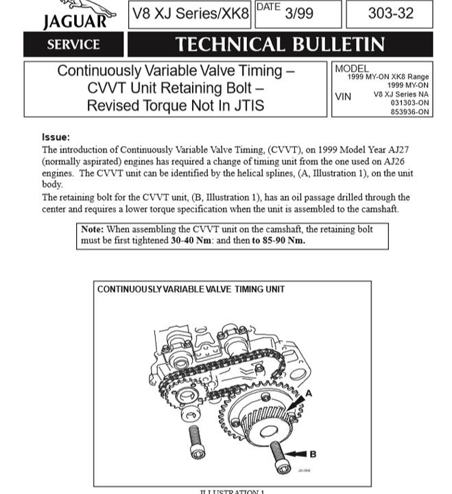

Also, an important note, the torque setting for the earlier A26 engine VVT bolts is 85-92ftlb, but the later A27 VVT bolts (which you have) is hollow and should only be torqued to 62-66ftlb.

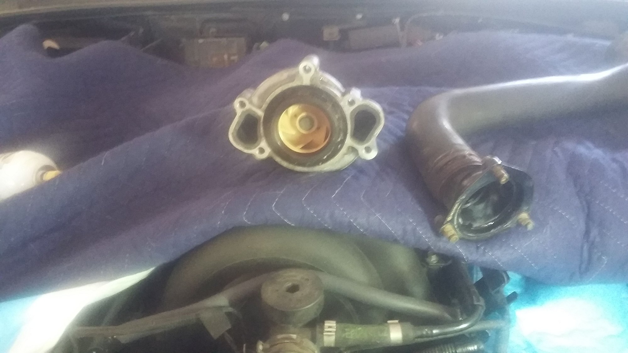

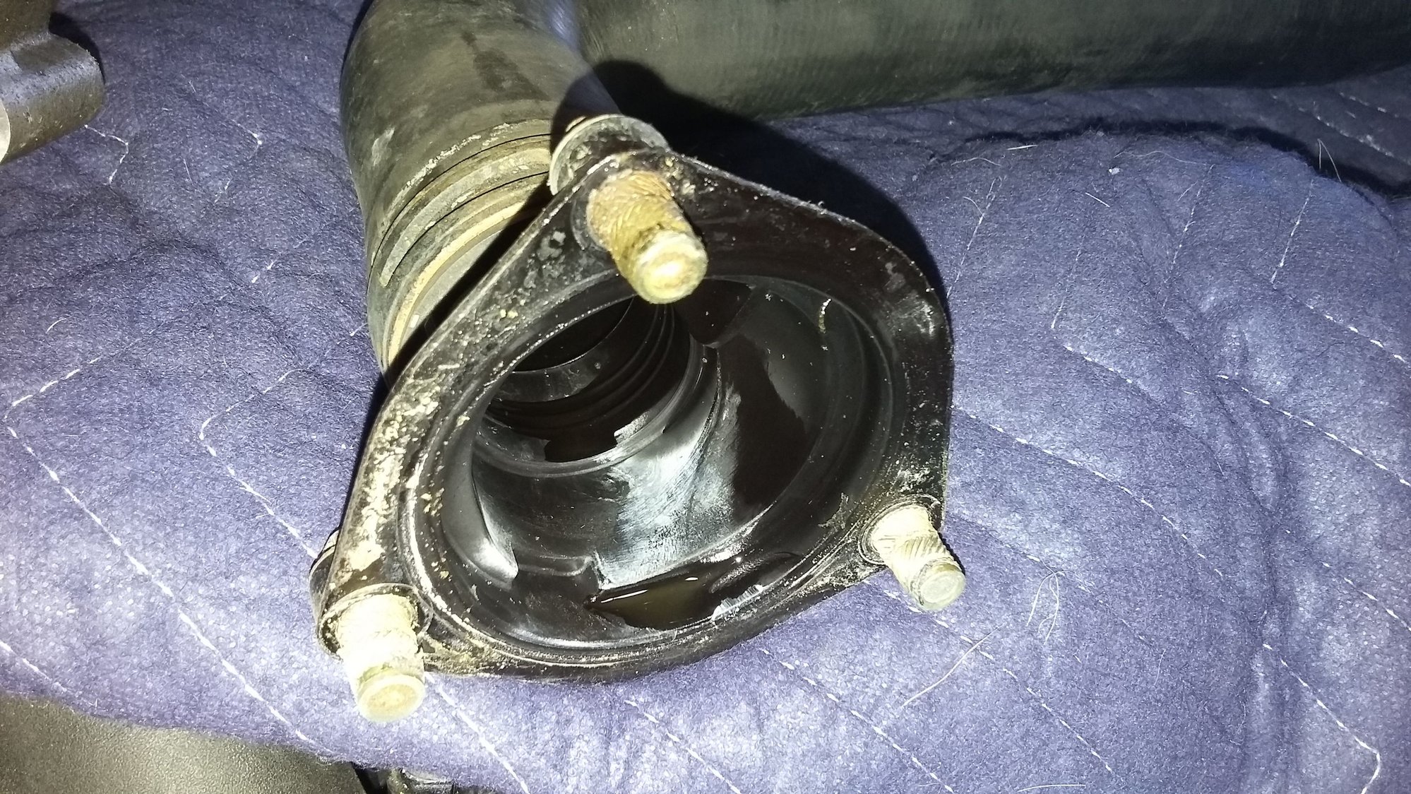

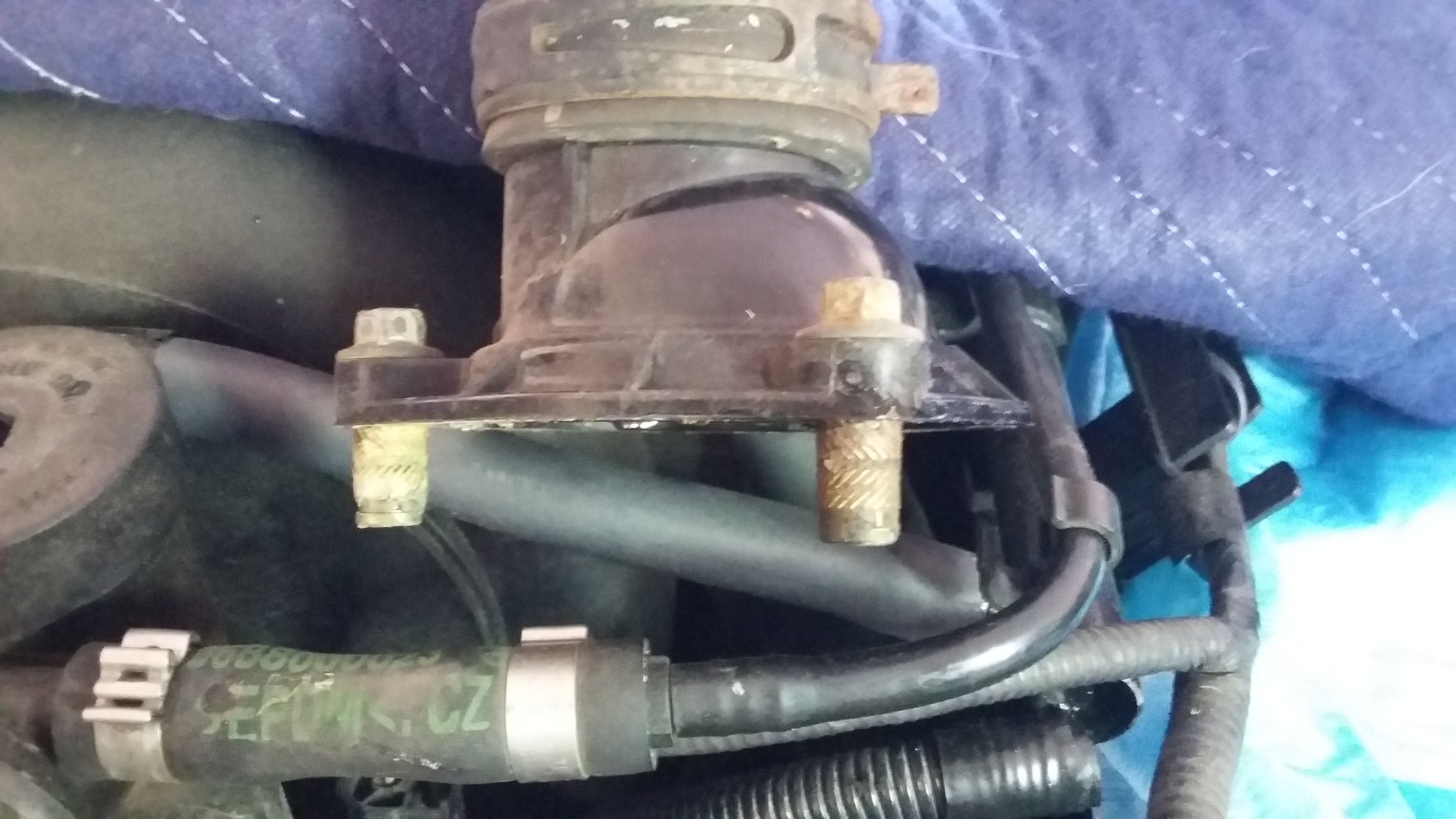

1st problem so far is the thermostat housing the blind nuts came out with the bolts.
Now one of the water pump bolts is fighting me, got it soaking now...

Blind nuts
Blind nuts stuck to the bolts
Water pump

Look on the positive side, you were going to replace the thermostat tower with an upgraded metal version anyway!

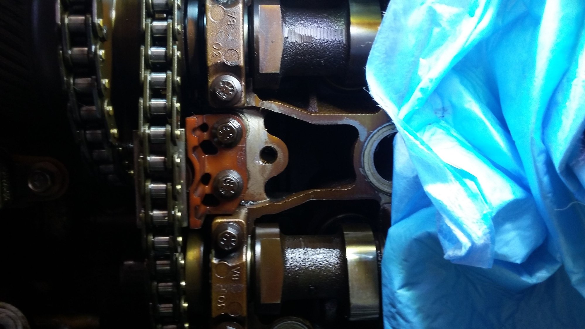

Likes: 1,371
From: Taiwan, R.O.C.
Originally Posted by Mrjay622
bits found under tensioner
After you replace those tensioners and guides, drop the oil and take the sump off.
You lost the shoe on that tensioner, and I am sure the rest of it is laying in the pan.
