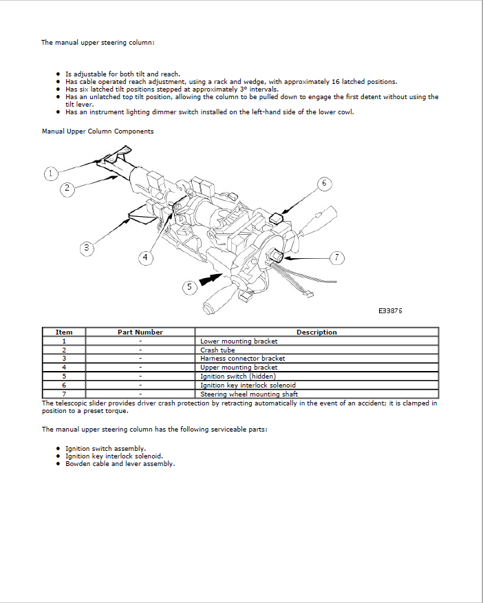

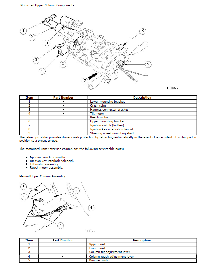

Read your pdf can't do step one. lol
I'll have to look how to repair the column the motor works, I'm guessing a gear is shot..

Both motors work tilt works fine just may be a gear went bad or wore out.
I don't think I'm going to worry about it for while.
No way am I going to get myself under the dash my neck just isn't going to do that right now.
Still wearing a braces 4 hours a day. Freaken old people!
Thanks for the diagrams.

Oh heck, I just threw them up there...give you something to look at and dial in a plan of attack. Perhaps you can print them out for Mint Sauce to evaluate...
