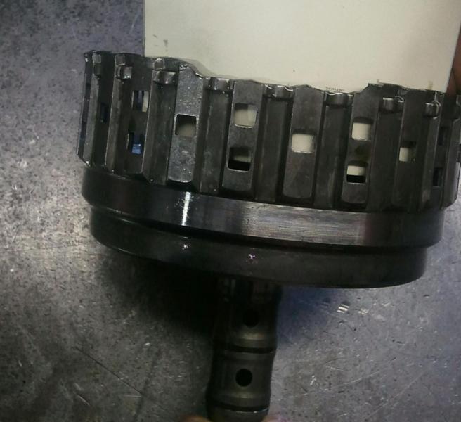

I spent a lot of time researching and a lot of time talking to the shop owner so he knows that I'm not going at this blindly. He will need to show me the drum being replaced and I advised him that he will need to order reinforced part. I gave him a link posted on this site for the drum. He said the valve body looks ok but sees what looks like a leak from differential. He said he does not work on them but will check the fluid level.
He is sending me a pic and I'll post it here for you guys. I asked which would be best, a rebuilt trans or replacing A drum. He said he warranties their work and not the part.

Here it is guys.

Hey- I've seen that before!
Definitely your problem.
Make sure he checks the o-rings in there as well- mine was broken.
You think?
