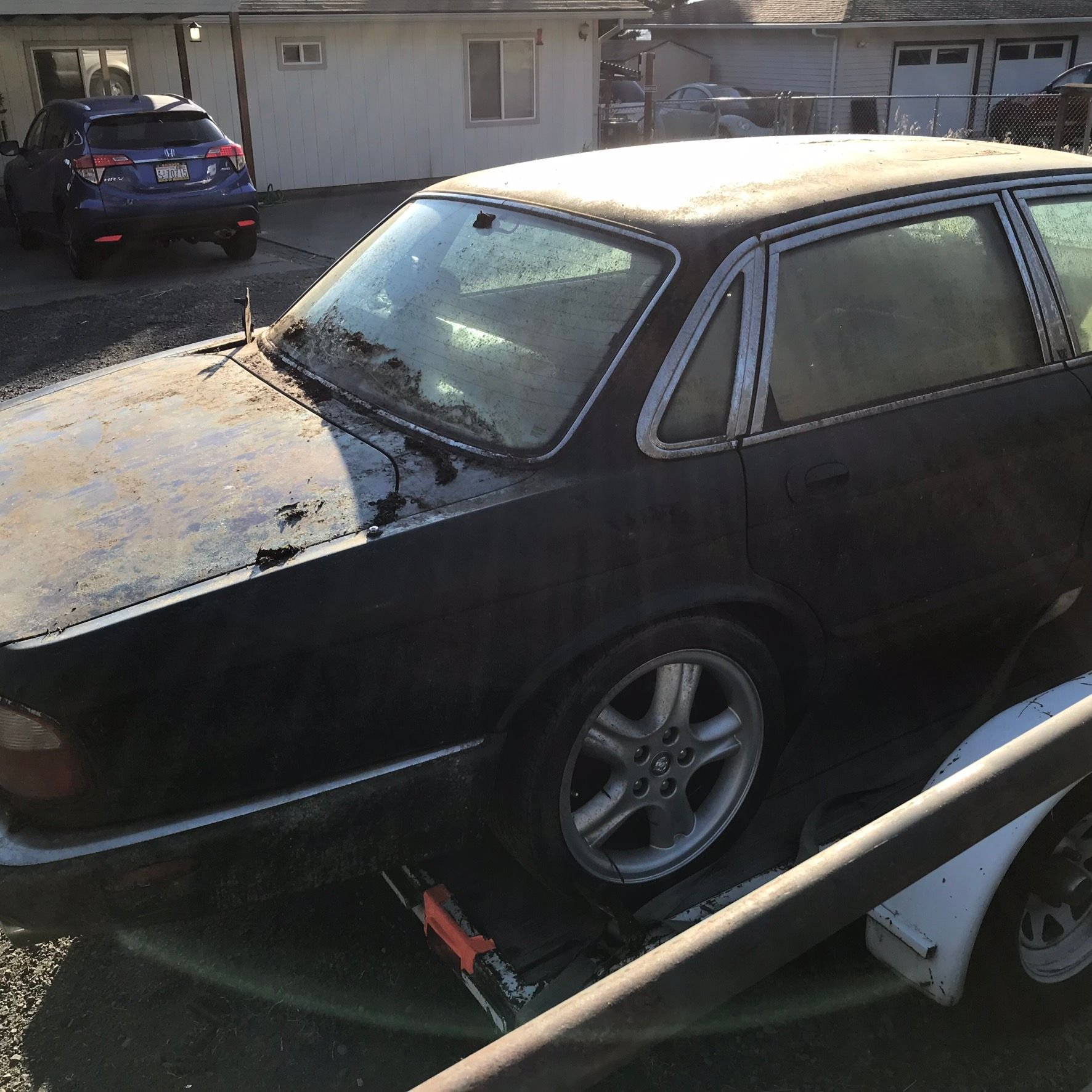

1998 XJ are back on the road after 10 years I bought this car earlier this summer missing a radiator the guy said he had gotten sick before he got time to fix it he didn’t remember what was wrong with it anyway I did a diagnosis found out the motor was frozen decided to swap it was a different motor when I changed it dumped the motor oil it was half water then the motor would rotate I did a compression test and some of the cylinders were dead with a camera I could see in the spark plug hole some of the valve seats so the motor was wasted I swapped it with another engine out of a car that had water damage from a bad sunroof and had other problems. I got it back in this new car today use the old radiator and I had to swap out the fuel tank as the first one was rusted the car started today ran Long enough to dump 5 quarts of oil out the oil cooler in the front it had a hose in a hole in it. I took the oil cooler off the other motor and just put it in I don’t have the right orange so I might get another leak but it is running there are many other problems with his car but this was the biggest wanted to get over ‘

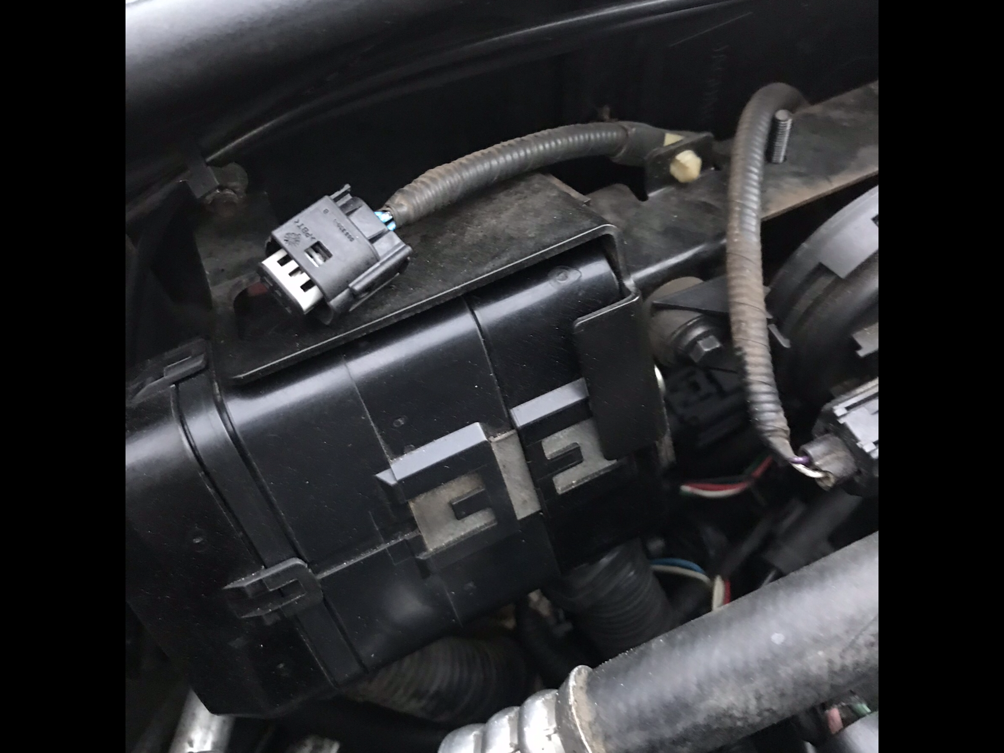

Old Oct 6, 2022 | 07:35 PM
Vonnslingo's Avatar
Joined: Jul 2020
Posts: 236
Likes: 58
From: Oregon
My iPad broke down on me and I couldn’t get on the form to ask the questions that I need to. Much is happened to his car and trying to run it back-and-forth about a couple miles on it helped it..Then the radiator that I installed was bad it was leaking and I just had to go back to the boneyard and get different radio room an xj8:: The supercharger has quieted down it’s got a little bit of Knox in it but not bad and I can certainly live with it it seems to be normal what everyone describes It stays in Restricted performance and it gives me a code of P1112 gives it twice I have double checked all the wires on the catalytic converter‘s and they are hooked up I have swapped out the Mas A couple times thinking that I had the incorrect one on there this card is a October 1997 and the motor is in October 1998 but I believe it is still considered an X308 it runs very good but it just won’t get out Restricted performance

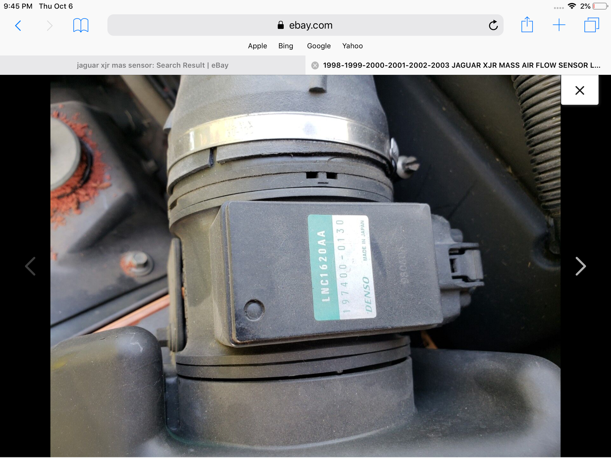

Old Oct 6, 2022 | 11:22 PM
Addicted2boost's Avatar
Posts: 3,125
Likes: 1,280
Since you have an AJ26 engine management, what’s the part number on the replacement MAF sensor? You cannot put a non-supercharged MAF sensor on a supercharged car. When my 98’ XJR started throwing rich codes for both banks, I did install a complete AJ27 supercharged MAF sensor with housing along with needing to switch a couple of the pins around in the connector and it’s been working properly for thousands of miles now.

Old Oct 6, 2022 | 11:55 PM
Vonnslingo's Avatar
Joined: Jul 2020
Posts: 236
Likes: 58
From: Oregon
Old Oct 7, 2022 | 12:14 AM
Vonnslingo's Avatar
Joined: Jul 2020
Posts: 236
Likes: 58
From: Oregon

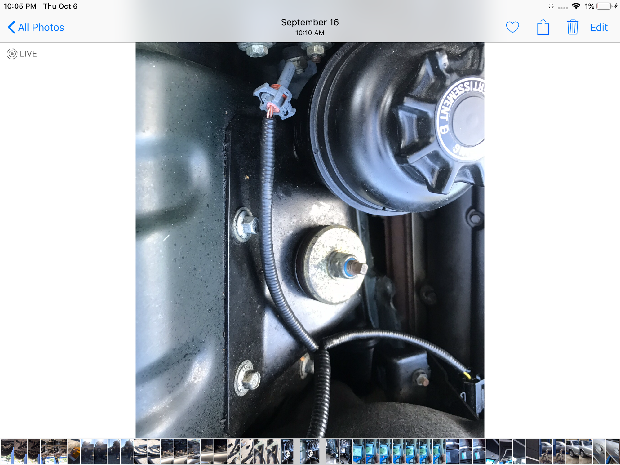

It is this type I ripped the pic off eBay...and I have some loose wires to ask about first are born same sensors on each side of
supercharger second wire cuts through the interior harness through the firewall nothing
