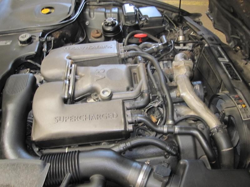

The pump for the intercooler circuit runs whenever the ignition is switched to the on position so that is likely that pump that you hear running. I would not think that the pump would have been damaged by the cooling being low but possibly that part of the cooling circuit became empty and the pump is now running dry.
There is a large recessed Hex cap at the front of the intercooler assembly that you can remove to check if the cooling circuit is full. I have used a Hex head bolt turned upside down with a pair of vice grips to open the cap as i did not have a large enough wrench. If needed, add coolant until it is filled and then replace the cap. The pump should hopefully now run without any grinding sounds.
Do you know why you were low on coolant?
