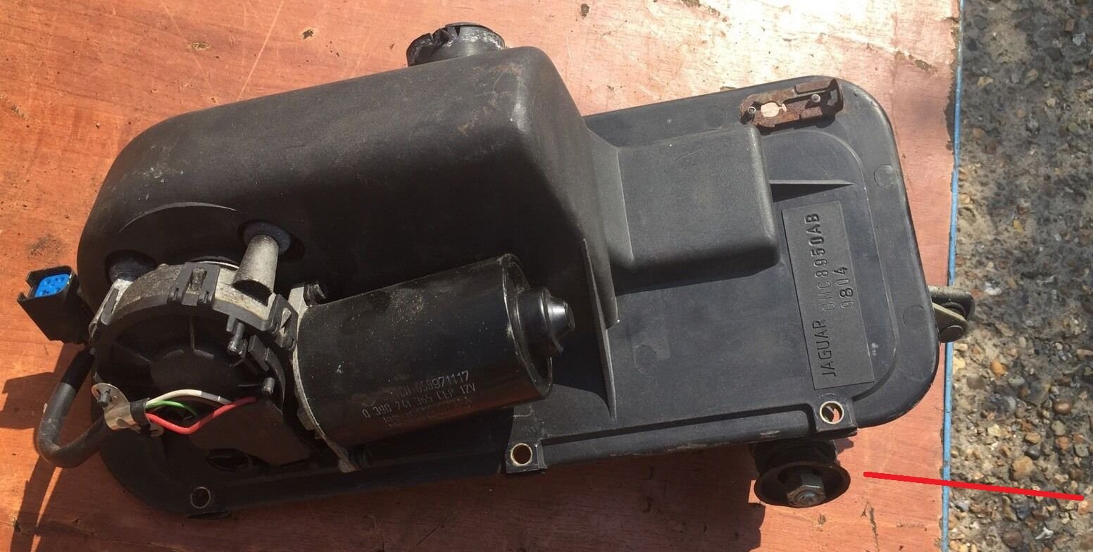

I had an issue with my wiper motor and replaced the unit the FSM says to replace the spindle seal. Would anyone happen to know the part number or where I could get this information?

The "Wiper Spindle Cover", no. 7 on the diagram, seems to be available at: https://www.jagbits.com/product/BEC22227.html. This "cover" is sitting in the (plastic) lower windscreen finisher.
However, this may not be the Spindle Seal that Michael (and the WSM) is talking about. It appears that there is a seal lower down on the spindle, as shown on this pic:
This seal is not shown in the parts catalogue.

I see it as the read mark
