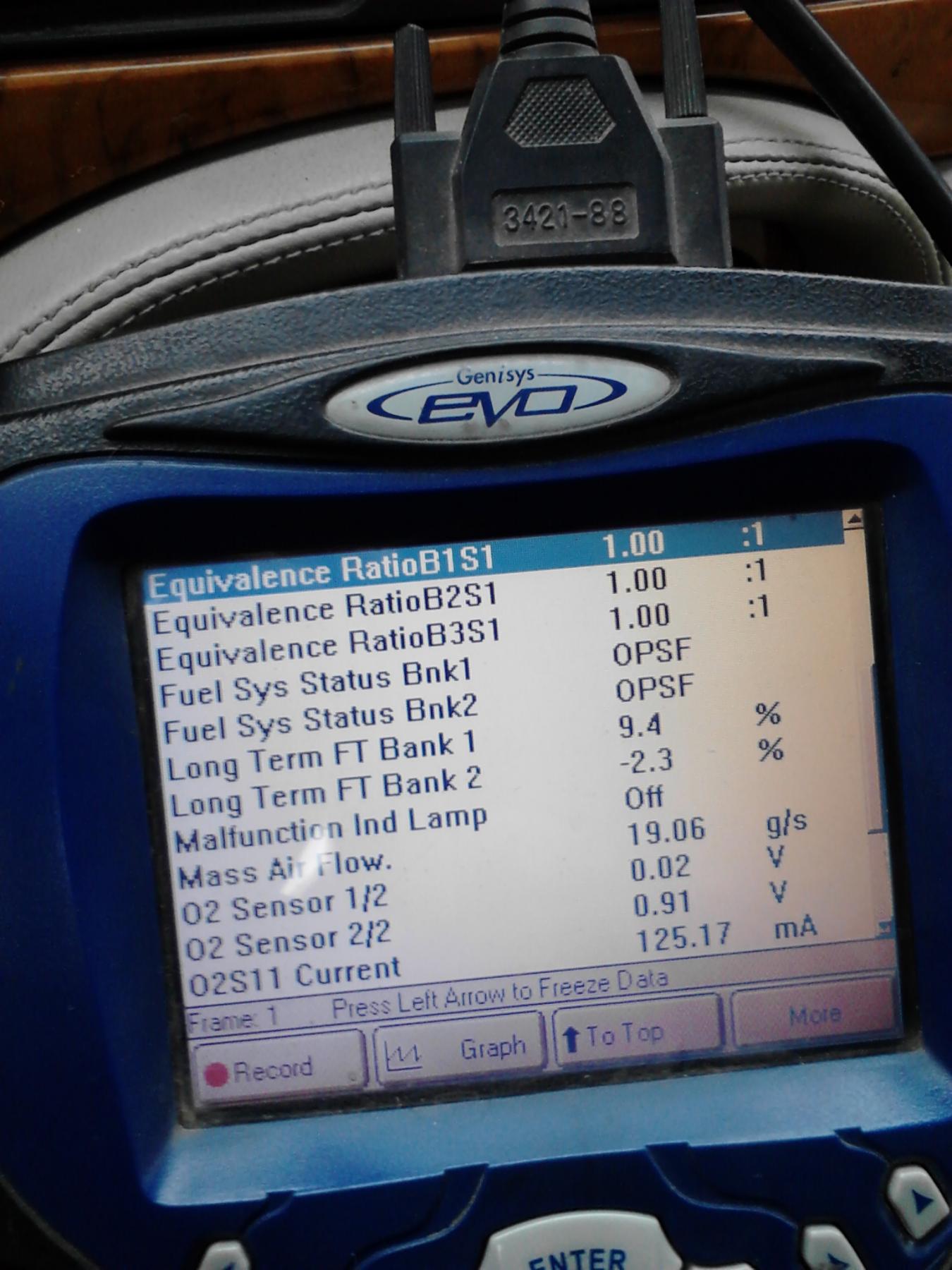

Heres screen shots of my scanner with car at idle. The last photo is with car at 2500 rpm's

Those screen shots don't look to have those big -ve LTFTs. Those would indeed mean rich and so PCM is reducing fuel (realtive to what it would expect).
You normally get lean codes for misfires. It's because the O2 sensors see the unburned mixture but can only see the O2. They cannot tell there's also fuel so the PCM adds more. Your -18 trims say it's doing the opposite.
But with P0300 you've got misfires. I guess they could happen due to being so rich the fuel can't burn.

Thanks and yeah I added the MAf yesterday so the high negative trim numbers are gone now.
Today I cleaned the coils, put a new coil on number one and installed a new O2 sensor on bank one, upstream, and these are the readings after I did that. When it sits there it acts as if it loads up. So I will pull the injectors and check them tomorrow. Other than pulling the cat off I think its all about covered. Just it can get to bucking so bad. Wish it had misfire mode like most obd2 cars did so I could watch what cylinders are misfiring when its happening. plus I like being able to pull up a history of the cylinders to see how and when they each misfired.
