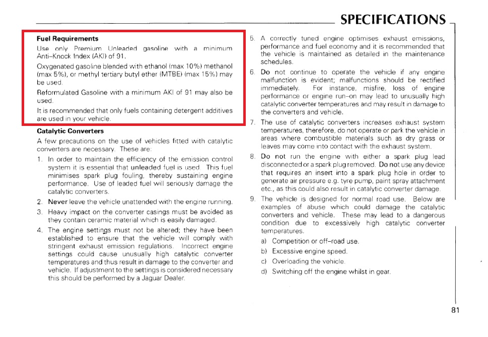

The fuel required depends on where in the World you are. Jaguar vehicle specifications vary for different markets and particularly the engine mappings are set to be suitable for fuel availability in the country in which the vehicle is sold.
When you get a minute, please follow this link New Member Area - Intro a MUST - Jaguar Forums - Jaguar Enthusiasts Forum to the New member Area - Intro a MUST forum and post some info about yourself and your vehicle for all members to see. In return you'll get a proper welcome and some useful advice about posting to the forum.
Fuel requirements are covered in the Vehicle Care Handbook. These are different publications and content for different markets as can be seen from the two examples for 1999MY below for US and RoW.
Fuel requirements for US market vehicle specification is Premium Unleaded with a minimum AKI (Anti Knock Index) of 91:
The recommendation for UK market specification is Standard 95 RON.
Fuel requirements for ROW (Rest of World) acknowledge consistent fuel grade is not always available:
Jaguar certainly make clear the possibility of damage from using low octane fuel.
