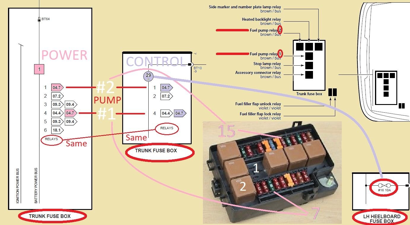

Did you guys get this fixed I’m having same problem. JaH has been garaged for nine years, ran fine as it was put away neatly, replaced the battery checked that shraider valve or whatever got no fuel just a psst of air now nothing put ten liters of fresh fuel and tried to crank it on full throttle, jumped the relay and as far as I can tell I can’t hear it come on! Did anyone get there’s sorted? I told my dad fuel pump replacement but he says well if it was put away five it might not be it!? Any thoughts fellow jag fans!?
Old Feb 11, 2025 | 06:31 PM
Parker 7's Avatar
Joined: Aug 2021
Posts: 4,699
Likes: 1,329
From: Kansas City

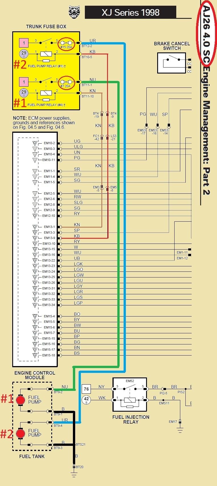

The jumpering of the # 1 fuel pump relay from the hot at all times socket 3 to 5 to the pump is directly powering the pump
The battery voltage may not have enough umf to break loose a stuck pump
With a battery charger as you increase the amp setting the battery charger can have more umf with the 50 amp charger start setting the highest voltage
You would have to use medium gauge jumper wire with blade type connector ends for best results , A common auto parts store can make one for you with a toy box of tools and wire behind the counter
A failing pump motor will arc and burn the on the fuel pump motor connector sockets so check for damage , also change the fuel pump relay as the power contacts inside will also arc and burn limiting the current to properly run the pump
The fuel pump will run for 3 seconds only on initial key rotation , it will come on for the rest of your drive by the CKPS seeing engine rotation , safety design
There is a secret fuse ( at the rear seats as point 29 double hash circle ) and a relay must close ( rear seat also ) for the fuel pump relay to have " control , closing " power to close the power contacts , different big amp fuse # 7 in trunk
# 16 / 10 amp left heelboard fuse box , the king relay in the corner of this fuse box must click closed on key rotation , you can test this by yourself with key in run and rock the relay in and out of the socket and feel click
Notice the big fuse # 7 trunk is between the relay and the pump motor electrically so can be misleading
double click on images for cleaner view
