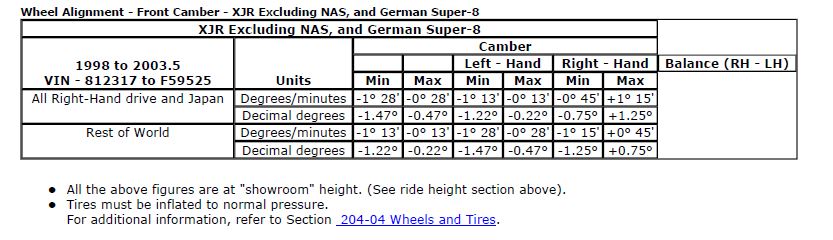

I am going to try something new.. I hope the jpeg attaches. It has the aligment specs for the XJR. I hope it works. Reviewing the post it looks like it worked.

Thanks, mate, much appreciated.
