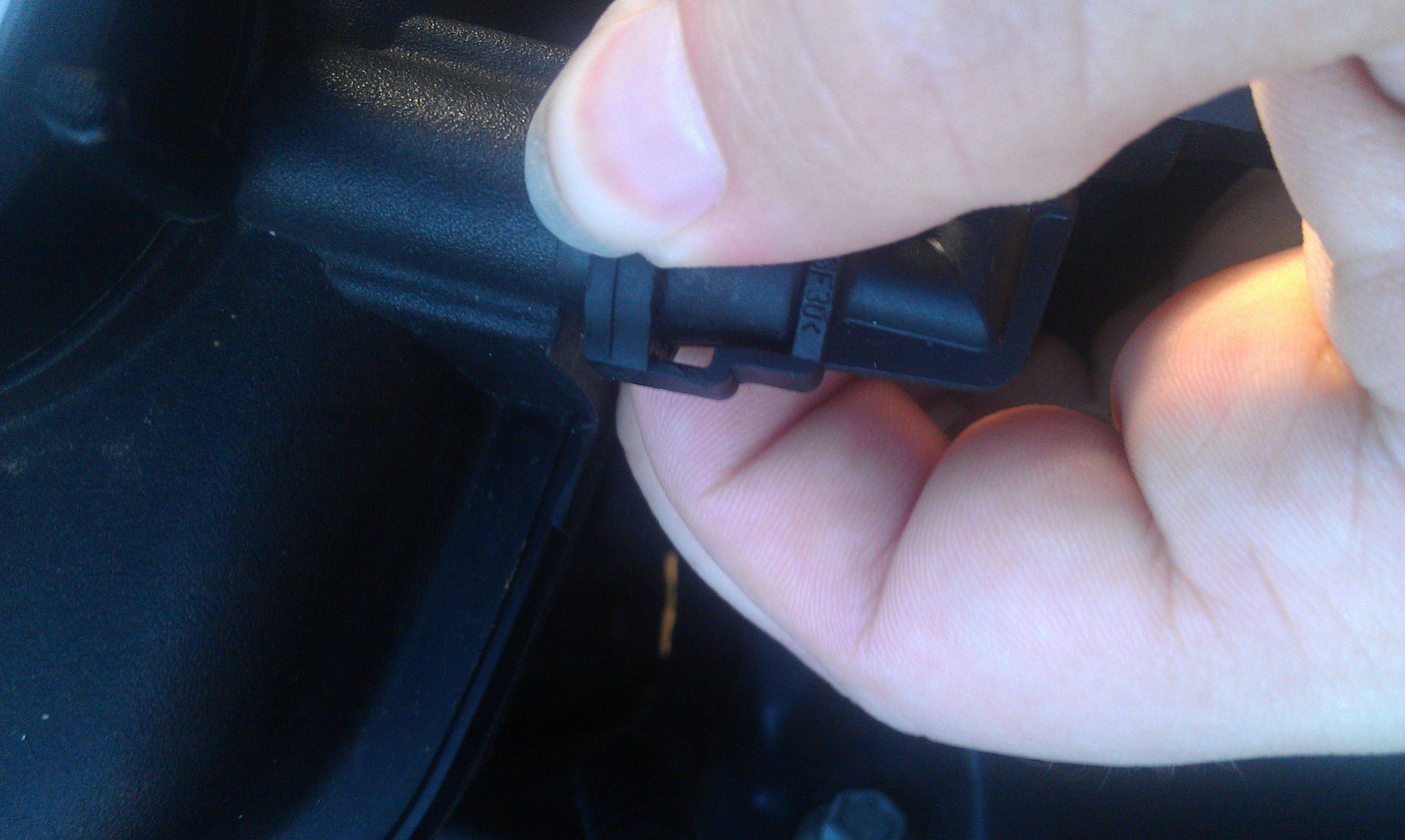

To remove these clips, squeeze the ring that runs around the outside over the open areas as shown. This will release the little teeth that go over the nipple coming out of the expansion tank.
Hope this helps!
