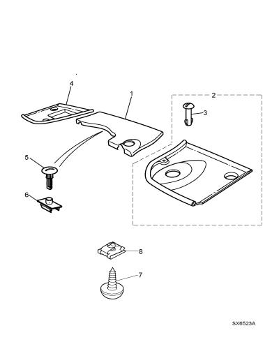

Yes, it is. Just above the Brake Fluid Reservoir (2), It has a long straight pointer line with (3) reference near where the front windshield would be.
The back of the engine compartment the Center Bulkhead cover has a hole where the Coolant Filler pressure cap is located.
Here is a diagram that shows the 3 engine compartment Bulkhead covers:
Looking at this diagram - the brake fluid reservoir is the right side of the diagram where it has a hole near its front edge.
Jim Lombardi
