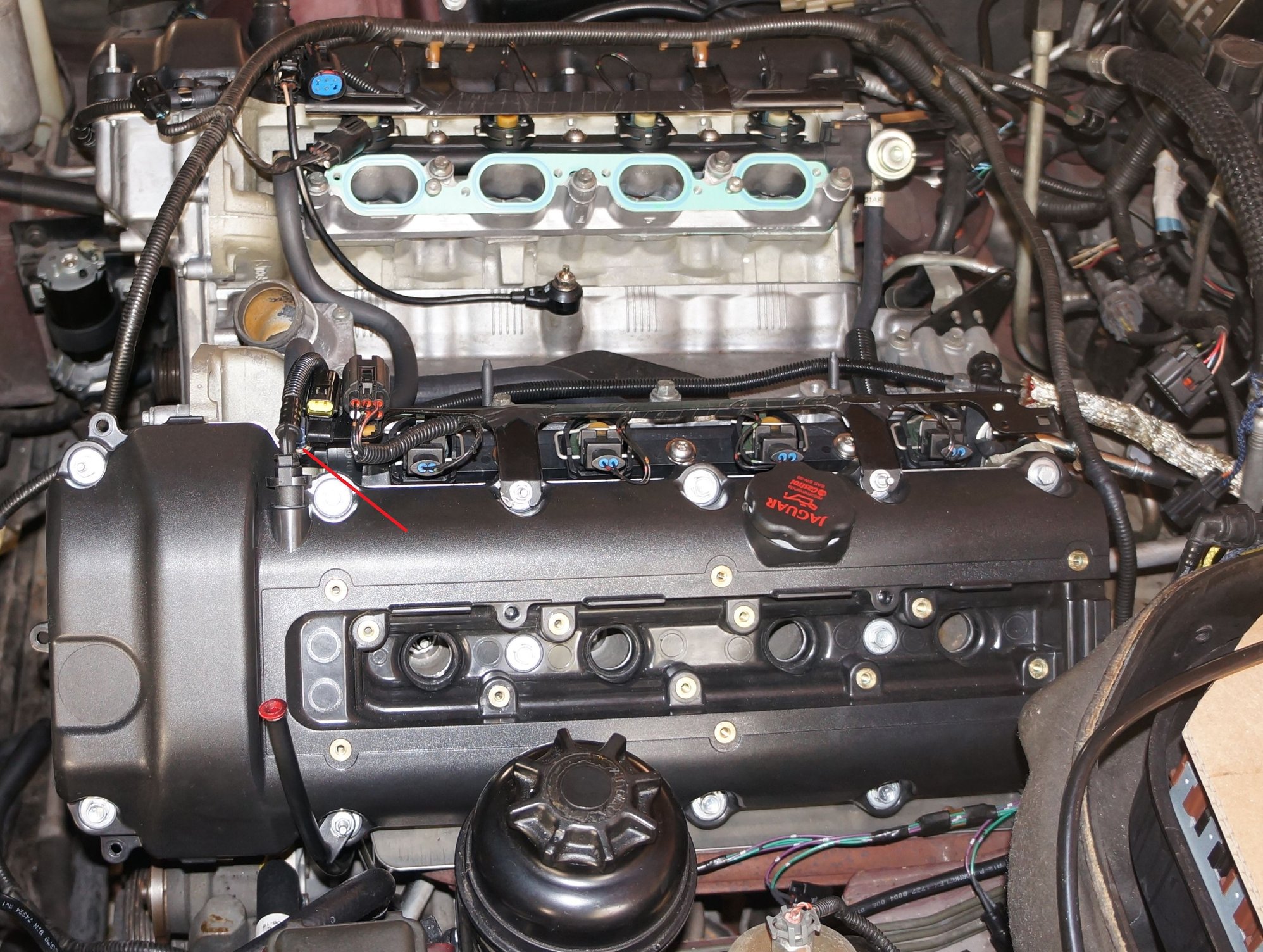

I wish I had a photo....but the valve is in the "valley" and at the left forward end of the fuel rail...just aft of what looks like a lifting loop/hole in the engine casting. You'll have to lean over the left fender and look back under a snag of wires (forward injector) and intercooler hoses at the left corner of the engine to spot it. Mine had a light blue cap on it....looks very much like a tire air valve sticking up almost vertical from a small black hose or pipe that dives downward and under the supercharger snout. Find that lifting hole in the aluminum casting and you're in the vicinity. The threaded cap can be removed with a long needle nose pliers. Good luck getting it back on...

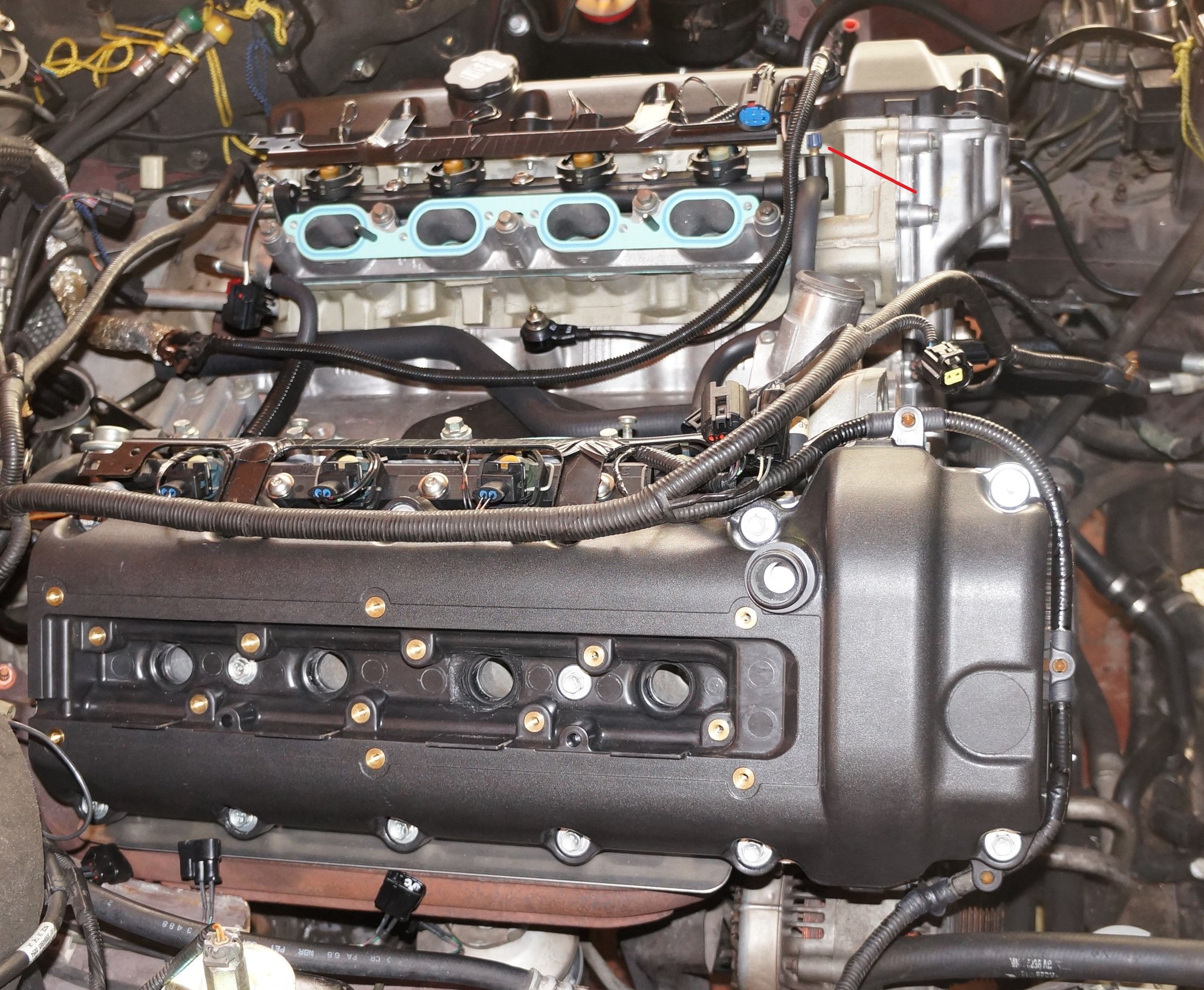

The fuel valve is pretty well hidden on SC engines. This is a 1999 AJ26 (blue valve cap):

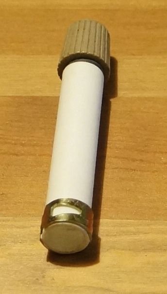

Special tool for removal of blue caps:

QUOTE=burntatf;2196425]Hi all,
Update this evening. Noid light confirms injector pulse. Yippee! I was able to locate the schrader valve. Thanks for helping me locate it. As stated above its on the front left of the engine, little blue cap now located somewhere in the valley of the engine. No fuel pressure, zero not even a dribble out the valve. So it's a delivery problem...[/QUOTE]
If you happen to spot the little blue cap, please let me know the location as mine is likely residing in the same hidey hole. I put a push on rubber cap over the shrader valve to keep the dirt out in the interim.
(Clever tool, M.Stojanovic)
