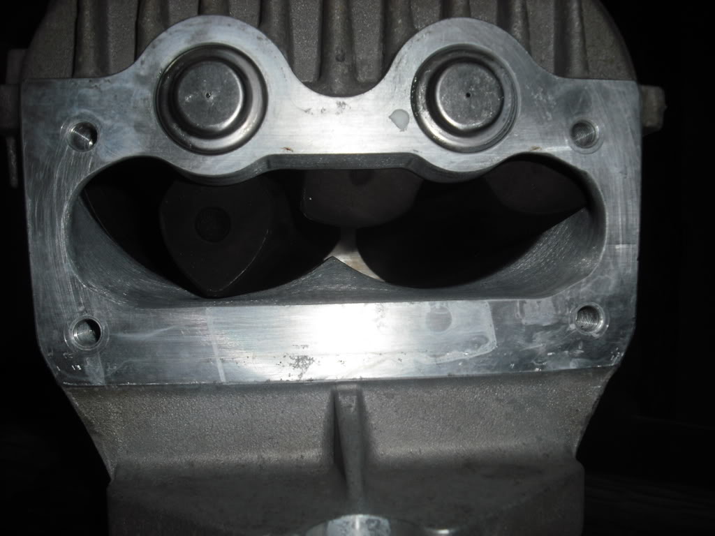

Jon bond's video shows an Eaton model where the rear bearings have to be pulled out from the inside requiring special tools. Our version of the supercharger uses bearings that go thru the case and are easy to replace. You will need a press to rebuild the snout but no other special tools are needed.
You can see the difference in this photo
Attached Thumbnails 2001 xjr s/c looking to rebuild-dscf0071.jpg

Thank you for that pic I can see the difference now. I guess I better start the tear down. Maybe I will post some pics to help others out in the future. Again I really appreciate all the advice you all have given me, if there is anything else I would love to hear it. Maybe change the knock sensor too while everything is out of the way.
