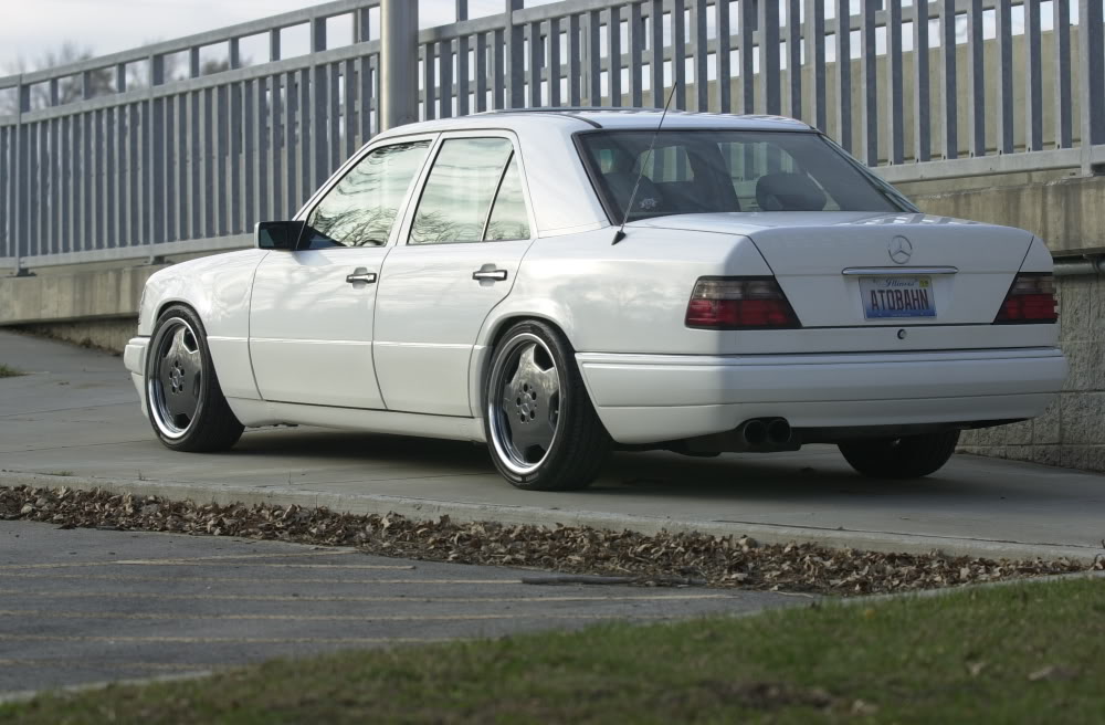

Too Jags are far from a stiff structure, so anything that is out there has to help. My W124 was an ingot compared to the wet noodle the Jag is. By far the Jag is a faster car, but it can't touch the quality of the Merc that was 7 years older.

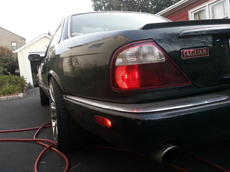

BadBenz94,I have the same car as yours, but changed a few things since purchase.before it was like exactly yours. sorry,my car is bit dirty

Beautiful car Vincent! Where'd you get the little lip spoiler for the rear decklid? I've been looking for something like that for quite a while, and that is exactly what I pictured in my head!
Painted Rear Trunk Boot Lip Spoiler for Jaguar XJ308 1997 2003 Sedan | eBay
